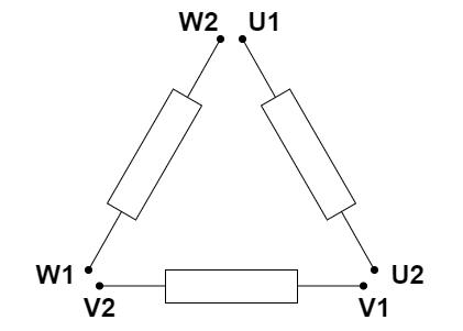

Connection of the motor on the output of the VFD is U1W2 , V1U2 and W1V2.
I would like to know what happen to a motor if one of the winding is connected in opposite direction, like U1W1, W2V2 and V1U2?
Running on two windings, a back EMF will be generated in all three windings.
Rather than being close to the applied voltage, the back EMF in the reversed winding will be opposing the applied voltage.

Yes, waross is right about that.
And it certainly could cause higher-than-normal current and higher-then-normal vibration (if it runs successfully at all). I think it would do that at any speed, but current and noise generally increase with speed anyway, so maybe you only noticed when it got to the problem speed? (did you ever go above the problem speed and if so what happened there?)

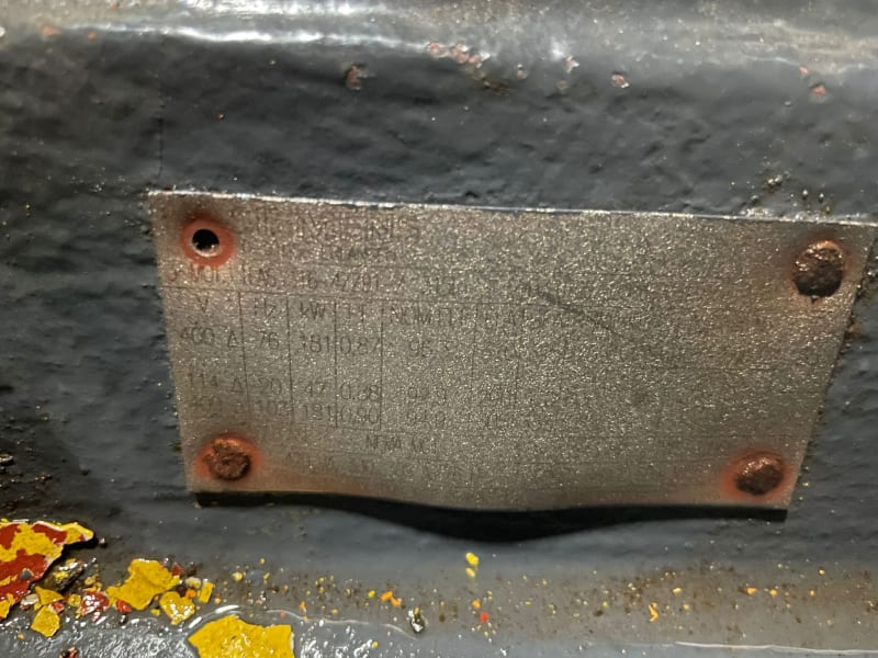

You are right, it's 2255 RPM. Nameplate is hard to read.
There is no motor terminal board, 12 high flexible yellow wires are coming directly from inside of the motor. Cable marking U1 U1 U2 U2 V1 V1 V2 V2 W1 W1 W2 W2.
That's a bad NP alright. If there are no terminal boards, how will you connect the VFD supply to the motor?
I am leaning towards one phase reversal due to wrong cable marking.
