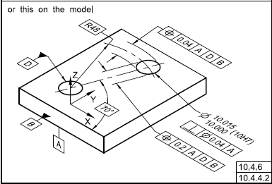

greenimi and All,
There are figures in Y14.5 with dimensions in a model-based isometric view. Figure 10-3 in Y14.5-2018 is a good example. The basic dimensions are not explicitly annotated, because they are defined by the model. The directly toleranced dimensions (the hole diameters, and overall length and width) are. There is also Figures 10-2, 10-17, 10-19, 10-26, 10-35, 11-6, 11-8, 11-31, 11-32 and others that have directly toleranced dimensions in the model-based view.
There was a figure in Y14.5-2009 (Figure 7-3) that was very similar to Figure 10-3 in 2018. The "screen image of digital data file" had the hole diameters but not the overall length and width. The 10-3 version in 2018 has directly toleranced dimensions for the overall length and width.
So the general methodology appears to be that basic dimensions are not shown in the model-based view, but directly toleranced dimensions are. But just to muddy the waters a bit more, in Figure 10-30 there are basic dimensions (a basic radius and basic angle) shown in the model-based view as well as directly toleranced hole diameter.

I understand the notation in the standard "or this on the model" to say that the shown part of the figure is a depiction of the model, not of a model-based view in a 2D drawing sheet.
Regardless, I don't think there is any restriction against specifying dimensions or tolerances of any kind in an axonometric view in the drawing (apart from the bit about all-around that was already mentioned here). I also don't think that such restriction would make sense.

I have to agree with Burunduk - "find where it is illegalized. If you can't, it is legal"
I don't know if this helps or not, but using ISO views on your drawing to fully define your definition is allowed...
Per ASME Y14.3-2012 section 9:
"To facilitate presentation of a design model and its
annotation, views depicting different orientations of the
model may be defined and saved in the digital data set.
See Fig. 9-1. These saved views may be used on drawing
graphic sheets that are part of the digital data set.
Drawing graphic sheets containing saved views may
fully define the product definition, or be used in conjunction
with the model or design model to fully define
the product."
