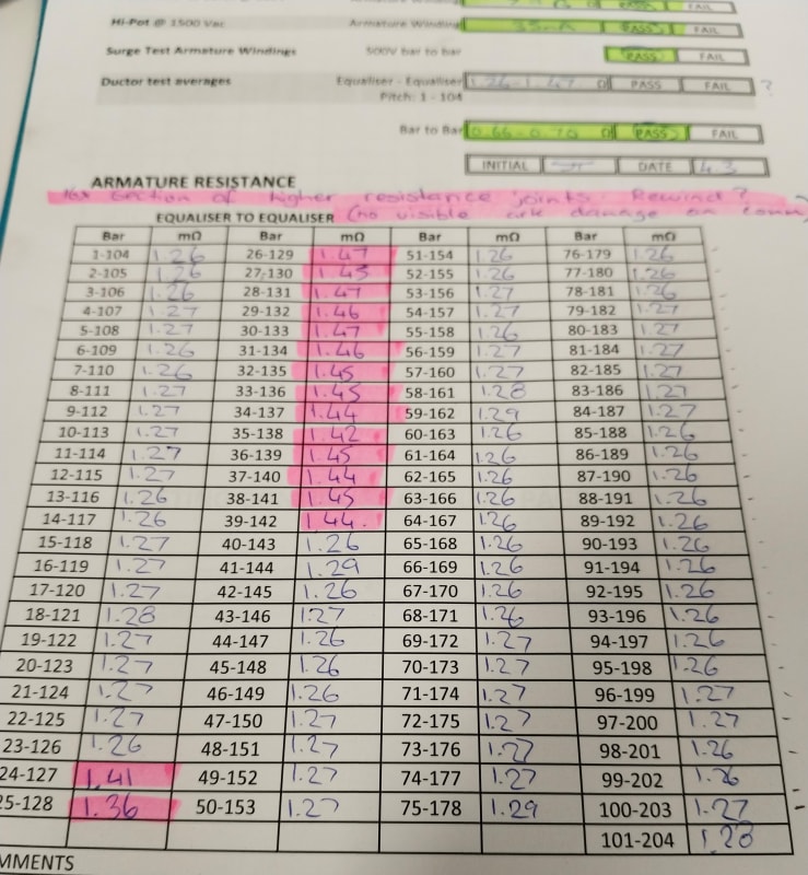

Need suggestion regarding DC traction motor Equalizer.
During periodic overhaul, while testing the commutator the bar to bar resistance values are within limit of 0.6 to 0.71 milli ohms, however the equalizer to equalizer resistance values 12 in a row are showing higher resistance values of around 1.4 to 1.59 milli ohms compared to other values which are around 1.15 to 1.29 m-ohms.
As a thumb rule if the resistance values 6 in a row are high then we suggest for rewind. However there are no relevant files on limits and guidance. Looking for suggestions on this.

A total of 101 Equalisers have been used in the old design. So the resistance value measured from 1 to 104, 2 to 105, and so on till 101-204.
Ria
It's 4 pole motor? For 204 segments, you should have 102 equalizers for 100% compensation and equalizer coil pitch should be 1 - 103.
Are the coils brazed or soldered? If they are soldered, then you can try resoldering those high points and most likely you will succeed.
Just because you are measuring resistance across the equalizer coil pitch (which in your case is also wrong), it does not mean you are measuring equalizer coil resistance alone. It is always in parallel with armature winding once it is connected.

Usually, the equalizers are tig welded and are not accessible until we remove the armature winding. I am trying to see if the motor can be put to use without rewinding, considering bar-to-bar resistance value measurements and equalizer resistance values, standard practice to decide either to rewind or reuse the same.
Since DC motors are a new area to me I am not sure of interpreting these results to decide whether to rewind or not.
