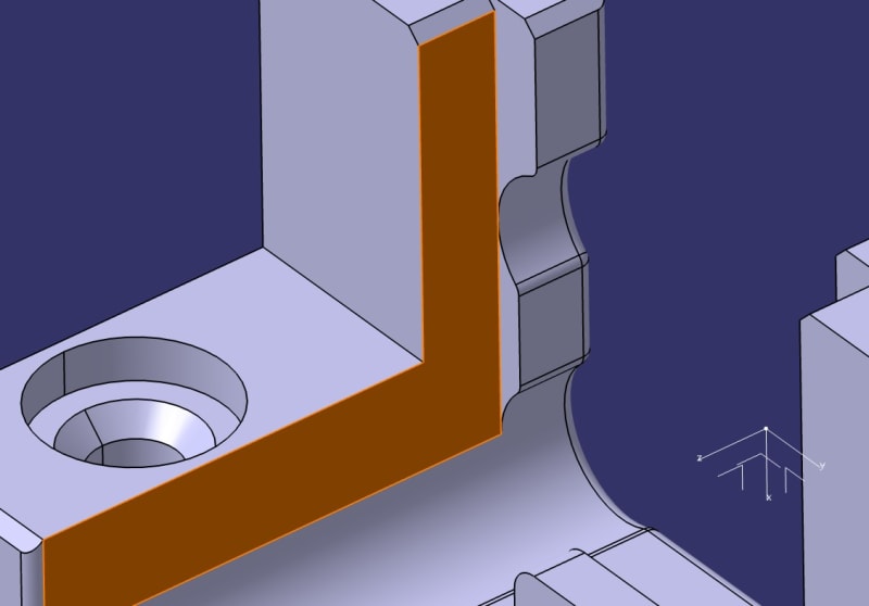

I have a part, attached below. This is a press die holder. A loose fitting die will lay inside the funky shaped area (highlighted).
Drawing view:
Now the problem:
First I want to control the die area going from the 15 mm opening to the bottom thickness of 5.9 mm.
Second I want to control the 19 mm wide opening up to the ledge on the back.
How is this possible? Is my current profile sufficient enough? It will affect the surface behind the middle ledge am I right?

I want to control simultaneously this:

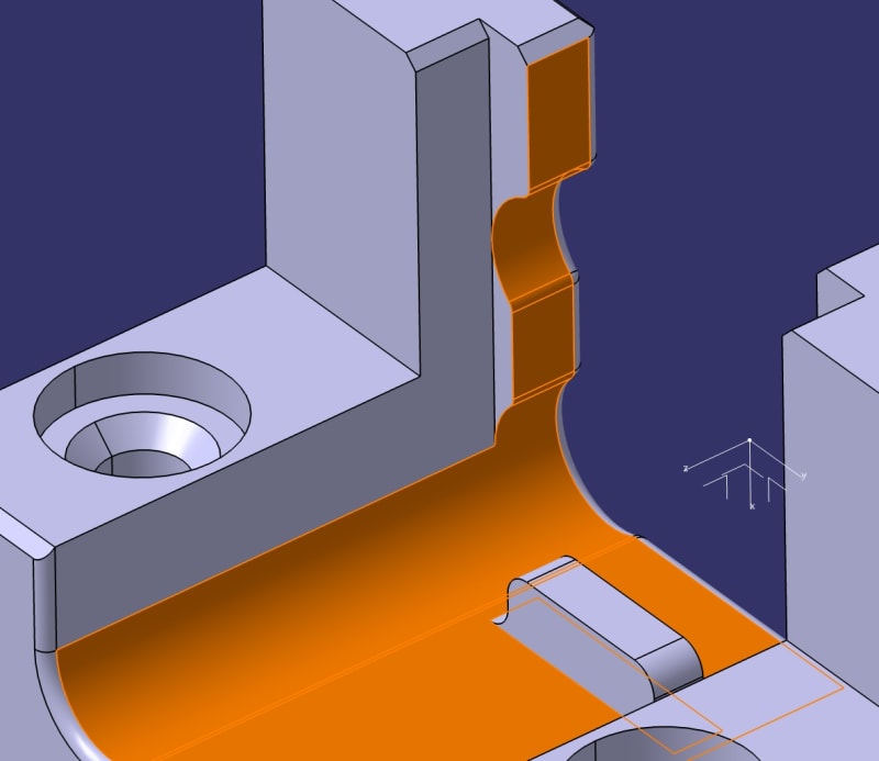

And that:
Because of tangency between the width and diameter I want to control them both at the same time.
I don't care about the ledge in the middle, that's directly toleranced and not that important. If the profile applies to it, then let it be, few dimensions less, not a big deal.
I'm having problems with the tangent zones. And the steps between 19 and 15 (and 17 below)

The current profile tolerance would only apply to the two planar surfaces that the leader arrows are directly pointing to. The usual Y14.5 method for indicating profile zone coverage is to use the between symbol and annotation points (e.g. P <--> Q ). See figures 11-8 and 11-9 in Y14.5-2018. However, this method is very limited - it only really works on surfaces with constant cross section. Your surface has different cross sectional shape at different "depths", and has an interruption where the boss is. It's very difficult to indicate areas like this using 2D views - the best way to make it clear would be to include an iso view with the intended area shaded.
You need 2 profile feature control frames referencing A, B, C. One, as Evan pointed out, with a "from-to" "between" indication to control the 15 mm width, all the radii and the bottom surface. Another one with two leaders, one for each planar surface of the 19 mm width.
If you're working per ASME, they all will be in a Simultaneous Requirement because of the identical datum references in the same order. Hence, you will "control them both at the same time".

Burunduk said:
Quote (Whuzhee)
I assume because of tangent continuity the profile tolerance goes all the way to the first sharp edge, in my case the chamfer.
That assumption is wrong.
In that case, even if a feature has radii between the surfaces the tolerance applies only to that surface where the leader is pointing to. So this is why the standard says "Where the extent of the application of the profile tolerance is unclear, the “between” symbol should be used." (11.2.1.1) and "When a profile tolerance applies all around the true profile of the designated features of the part (in the view in which it is specified), the “all around” symbol is placed on the leader from the feature control frame." (11.3.1.3)
Figure 11-24 to 11-29 backs that up by always indicating the all-around specification.
