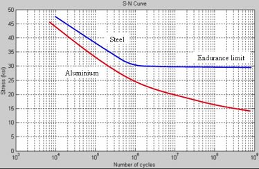

And, as always, something to bear in mind with aluminum is that it does not have an infinite fatigue life -
