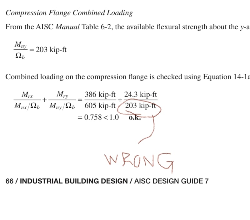

Hello guys,
I'm studying AISC's Design Guide 7(Industrial Buildings Design) and i have a question about a design example of the Guide. The question is about Weak-axis flexure in the example 14.1.1. I undersand that, since the transverse impact occurs on the top flange only this flange can be counted upon for strength and deflection. For the deflection calculation, the moment of inertia of the section is halved, which i consider correct, but the bending strength is not. The guide considers the full strength of the section.
Is the solution wrong or is there something that i'm getting wrong?

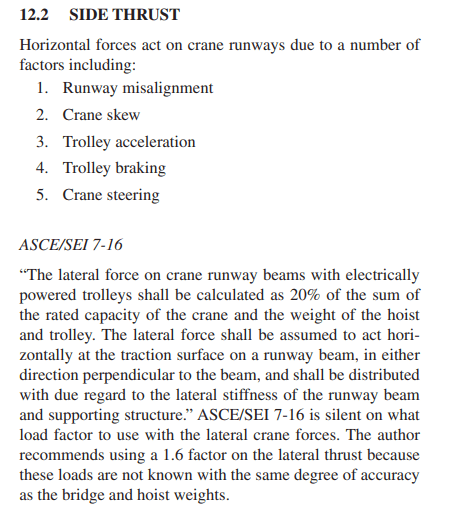

1)When the text says that "The lateral force shall be assumed to act horizontally at the traction surface", the traction surface isn't the compression flange for overhead cranes and tension flange for underhung cranes?
2) What i'm talking about is equation 14-1a, so its not considering web sidesway buckling.

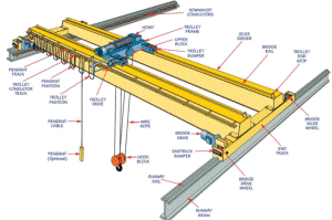

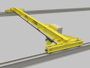

Design Guide 7 concerns CMAA "Specification for Top Running Bridge and Gantry Type Multiple Girder Electric Overhead Traveling Cranes", (see introduction to Chapter 10).
I suppose this would include the following arrangements:
but, in both cases the (traction) runway flange is the compression flange... and your question is about design of the runway (Chapter 14).
Reread Design Guide 7, starting with Chapter 10 "Industrial Buildings With Cranes", and keep in mind the CMAA specification about "top running".

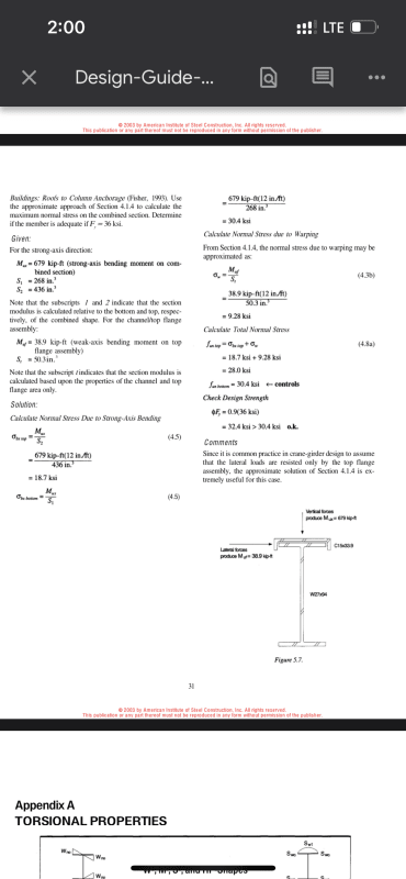

I agree with you the strength interaction in the design guide has a mistake (for W24X31).
In the example you mentioned they used the full weak axis bending strength when they should have used half (top flange only). If you look further in the document where they calculate the strength of a W+cap channel, they use only the top flange assembly to encapsulate the lateral strength, which I believe was there intention in the first example you mentioned. If you look towards the end of AISC design guide 9, you will find another crane girder design example, which uses similar design principles, although slightly outdated. I believe you can also find examples from Civil Bay (I think on either AISC Steeltools or Civil Bay website).
