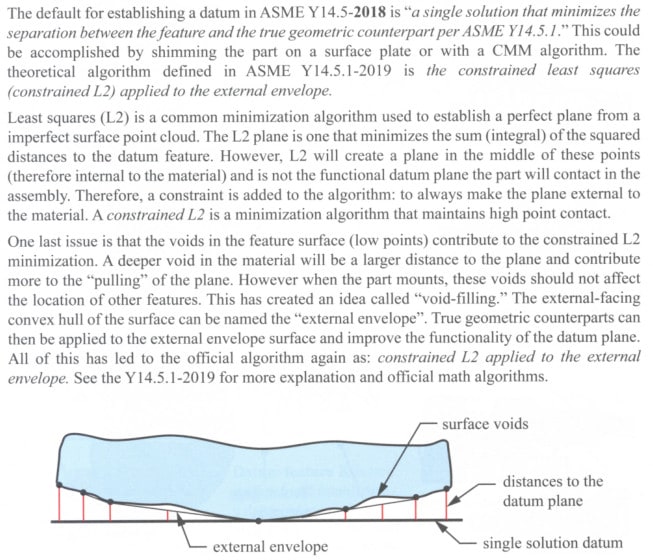

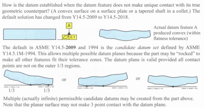

The "single solution" issue was made more complicated by the release schedule issues. In the mid-2010's, Y14.5 decided to move away from the "candidate datums" default for planar datum features and wanted to define a "single solution" instead. They asked Y14.5.1 for help with potential definitions for the single solution, and various methods were proposed and studied. Some of these are described in a nonmandatory apppendix in Y14.5.1-2019. The recommended definition for the single solution mentioned in Y14.5-2018 is the "constrained L2" simulator. This is a type of constrained least squares algorithm, that defines a reasonably equalized and stable datum plane for most configurations of as-produced geometry.

So the question is - should the referencing features be accepted based on:
A) Using a mathematically rigorous solution that doesn't represent the installation
B) Finding at least one solution to the datum simulator generation process that allows accepting the referencing features
C) Requiring that the features be accepted for all candidate datum simulators
With a fixed gauge choice B is automatic - it also matches how the part is installed, that is, the assembler is not trying all installation solutions and isn't performing a constrained least squares solution.

My understanding is that the constrained least squares for a plane in this example does a least squares fit to the planar part surface, and then forces the plane somehow outside the material. How that calculation is made is proprietary to pcdmis(cmm), but here is a quote from a member of that team:
"It does a least squared fit first, then shifts, external to material. I obviously can't share the exact algorithm on a public forum as it is Hexagon's intellectual property"
If I remember rifling thru the pcdmis manual a while back going over this topic, it is similar to a cylinder as well...least sqr first then force it externally with stabilization.
I don't like it being called constrained least squares, I think it should be called external least square so you know it is an external fit.
sendithard,
The mathematics of the constrained L2 fit are summarized in a nonmandatory appendix in Y14.5.1-2019. It's generic mathematics. Regardless of what a Hexagon person may have said or implied, the constrained L2 fit is not based on intellectual property from Hexagon or anyone else. There may be proprietary algorithms in PC-DMIS for computing the constrained L2 from point data, but the definition itself is not proprietary IP.

Speaking of GeoTol and Scott Neumann who were mentioned above by greenimi, I found some brief commentary on their website about the new "Constrained Least Squares" default: "What's new in ASME Y14.5-2018?", that also includes this illustration.
According to GeoTol, "This can be done with shims on a surface plate or with an official algorithm further outlined in ASME Y14.5.1 Mathematical Definitions of Dimensioning and Tolerancing Principles to be released at the end of 2019."
Can anybody describe how the "single solution" can be achieved in manual inspection, using "shims on a surface plate"?

Better quality image
Season
SeasonLee,
Thanks for the clearer image.
Does your source include the Y14.5-2018 default too?
Its a snap shot from GeoTol Pro 2020 textbook, the following image for those who are interested to read.

There was no need for the term "void filling" as that is already a function of creating the convex hull. It's right there - "convex" means no concave portions.
Another way to describe "single solution" is that all the feature control frames essentially have a simultaneous requirement to use the single solution - the component is not allowed to be repositioned during inspection for any datum references that match. All having, for example, "A" as the primary must use the same derived "A" regardless if the features are "SEPARATE REQUIREMENT" under the "single solution." What can be repositioned under that condition is the Feature Frame, but that's not what the standard implies.
