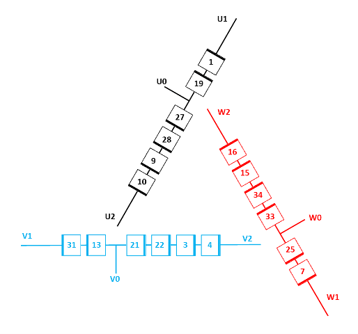

Recently, many motors with 9 terminals have been appearing in workshops.
These motors are designed for one voltage and one speed.
For more information, please visit the following link: [URL unfurl="true"]https://winding.wixsite.com/design/post/unusual-example-from-practice[/url].
This new motor design appears to use a different starting method (hopefully will be useful for winders).
During the start, the motor is connected in a serial YD configuration, as shown in the attached diagram.
During the running period, the motor is connected in a simple 1Delta configuration.
Can someone explain this theoretical case, and how much the starting current decreases compared to other starting methods such as DOL, Y-D,or PWS?

You might be right, but I'm not sure. It seems it would be tough to predict how that winding would act during start in that described starting configuration ("series wye delta"). I think you're analysing it a little bit like a transformer winding, but the phase of the voltage induced in a coil group depends not just upon its position within the electrical circuit but also upon its mechanical position around the circumference.
For the blue phase, the proper 4-pole-winding phase relationship for the 13 / 31 coil groups with respect to the 21/22/3/4 coil groups would be obtained IF power was applied between V1 and V2 (a big delta including all coils). Connecting U2 to V0 etc would disrupt that phase relationship. so I'm doubting the phase relationship would still be correct in that "series wye delta" connection

Let me try an overly simplistic circuit analysis of the start configuration which just treats the coils as impedances (the kind of thing I warned against before, since it ignores their position in the core and proximity to other phases) in a half-@ssed attempt to come up with some number for the starting current. (no guarantees that it's right, even if I don't make a math mistake).
Let's say Z0 is the impedance of each group of 2 coils (each box in the figure has an impedance Z0).
So we have in the center of the configuration a delta with impedance 4*Z0 in each leg. Outside of each corner of the delta we connect to the line through 2*Z0 in a wye-like manner.
Let's do a delta-wye transformation of that inner delta. The equivalent impedance in the wye leg is a factor of 3 less than the original impedance in the delta leg. The delta with 4*Z0 in each leg transforms to a wye with (4/3)*Z0 in each leg.
Now assemble it with the outer wye and we have a wye with 2*Z0 + 4*Z0/3 = (10/3) Z0 in each leg of that bigger wye.
Compare that to a normal wye/delta start where during start the wye would have 6*Z0 in each leg during the start. The series-wye-delta is going to have higher current than a wye connection by a factor of 6/(10/3) = 18/10 = 1.8. In other words if the wye/delta reduces the starting current to 1/3 of what it would have been if started directly in delta, the series-wye-delta/delta reduces it to (1/3)*(18/10)=3/5 of what it would have been if started directly in delta. On that count it wouldn't be as good as the wye-delta if this answer is to believed. BUT, I'm not claiming that answer for current is the correct answer, just a math exercize whose foundations are pretty dubious (even if I didn't make any math mistakes along the way).

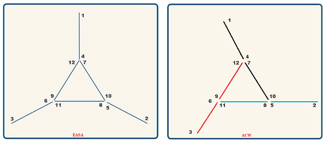

Hi Pete,
Your thoughts are very similar to mine regarding the starting torque (60%). To confirm our findings, it would be helpful if you could provide your estimation for the same winding but connected in a way where each internal D-leg has 2 coils and the external Y-leg has 4 coils.
If your result matches mine (approximately 43% of nominal torque), then we are on the right track. However, we should keep in mind that this doesn't necessarily mean that our calculations are completely accurate. It would be beneficial to hear from other experts on this forum.

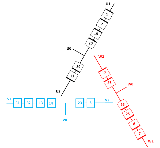

Yes, 0.43 is the same answer I come up with for that new configuration. Below I repeated the previous analysis using the new configuration
electricpete - revised for new configuration said:
For that configuration the inside delta has 2*Z0 in each leg. Outside of each corner of the delta we connect to the line through 4*Z0 in a wye-like manner.
Let's do a delta-wye transformation of that inner delta. The equivalent impedance in the wye leg is a factor of 3 less than the original impedance in the delta leg. The delta with 2*Z0 in each leg transforms to a wye with (2/3)*Z0 in each leg.
Now assemble it with the outer wye and we have a wye with 4*Z0 + 2*Z0/3 = (14/3) Z0 in each leg of that bigger wye.
Compare that to a normal wye/delta start where during start the wye would have 6*Z0 in each leg during the start. The series-wye-delta is going to have higher current than a wye connection by a factor of 6/(14/3) = 18/14 = 1.286. In other words if the wye/delta reduces the starting current to 1/3 of what it would have been if started directly in delta, the series-wye-delta/delta reduces it to (1/3)*(18/14)=6/14 = 43% of what it would have been if started directly in delta
It's a number calculated from circuit analysis assuming the coil groups act like simple impedances. As we both noted, it's not clear whether or not that is a completely valid approach here. I tend to think the accuracy of the answer rests on how faithfully the winding creates a roughly sinusoidal 4-pole variation in space (neglecting high order spatial harmonics from slotting). If it doesn't create that type of pattern, then the voltage induced by the airgap flux into the coil groups is going to vary among groups in the same phase. Since the full delta creates a sinusoidal pattern with this physical coil layout and the series-wye-delta uses the same physical coil layout with weird (hard to analyse) electrical phase shifts, I think the series-wye-delta gives a lot less sinusoidal pattern than the full delta.
I'd also be interested to hear what others think about it.
A note about the direction of the error....
I think if the flux pattern is non-sinusoidal, then the above estimate is most likely low.
i.e. The actual starting current would probably be higher than 60% (original starting configuration) or 43% (revised starting configuration) of the starting current that would occur in delta.
It is important to note that each leg, either in the internal Delta or external Wye, must have a real 4-pole winding ( in this particular example). Therefore, it is not possible to achieve this winding pattern using only 3 (the same number) coils in each leg. If we wanted to do so, we would need to use another type of winding, called a mixed or double-layer winding. At first glance, such a connection will provide approximately 50% of the starting torque.
As it is evident, this enables us to better customize the motor to the specific load during production or repair: 33%, (43%, 50%, 60%), or 100%. It should not be overlooked that any increase in the starting torque results in an increase in the starting current.
In fact, it is evident that these mentioned connections are very similar to the standard Y-start, D-run starting of the motor. By reducing the number of coils in the internal Delta, we move towards the classical 1Y connection (when there are zero coils in the internal triangle) and vice versa. The reduction of coils in the external Wye leads to the classical 1D connection.

AC Windings
Dear All,
These conection is also used for running motors delta rated @ 460 V at 575 V with a 15 % torque reduction. See the technical article: A closer look at winding conversions by reconnection.
Regards
Petronila
petronila nad electricpete,
Yes, that is very similar to the original post, except that the original post refers to starting currents and torques of single-voltage windings.
By the way, the diagram you provided (the diagram on the left) doesn't seem to be the most suitable, as it can be misinterpreted as implying a phase shift between parts of the same phase, such as 1-4 and 7-10, which is incorrect.
The diagram on the right shows the way we represent such connections.
