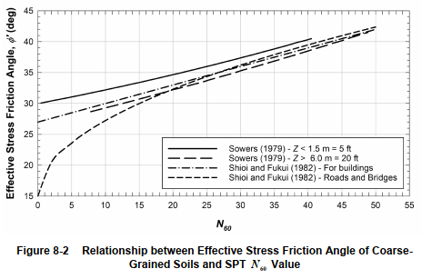

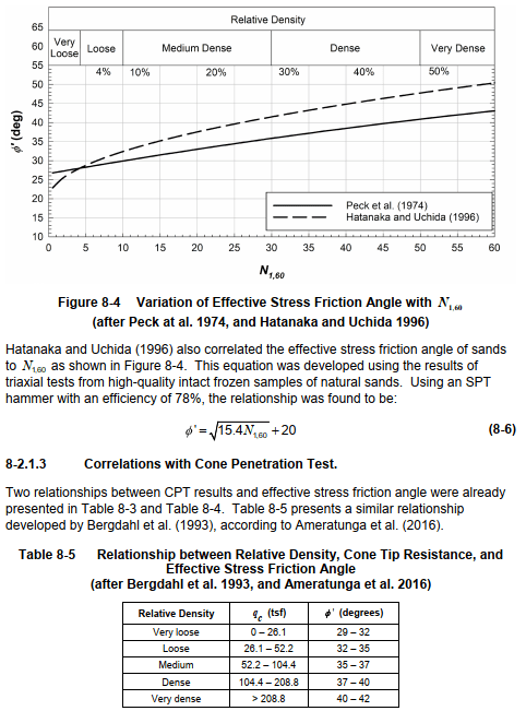

Stop assigning a friction angle to N-values below 4 in saturated very loose sands. In the chart below from Peck, where geotechnical engineers are getting 28 degrees, it is not applicable the line ends at very loose. Determine the undrained strength and if this material is susceptible to liquefaction displacements.

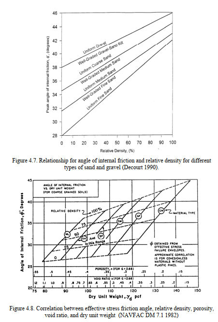

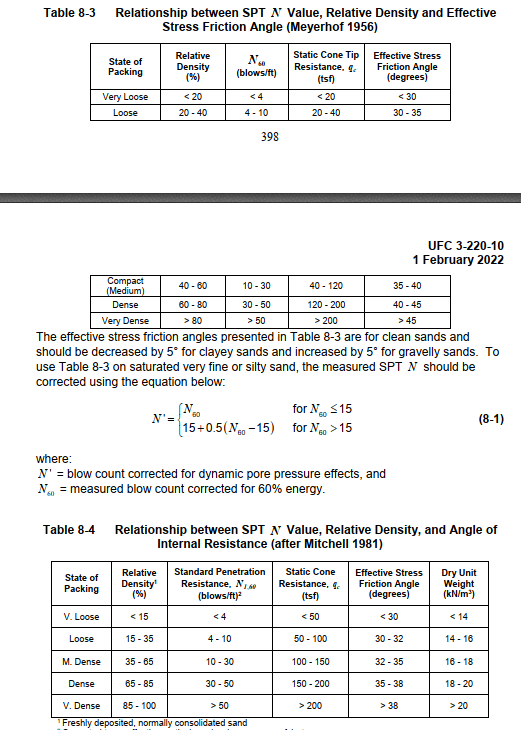

28 degrees is used in a couple of references, but shouldn't be used blindly. My approach is looking at the material type and assigning a friction angle that makes sense. Silty fine sand will be lower than well-graded fine to coarse sand. Dig through the piles of information on this subject and make an educated decision. UFC 3-22-10 (DM7.1) has some great information to dig through.

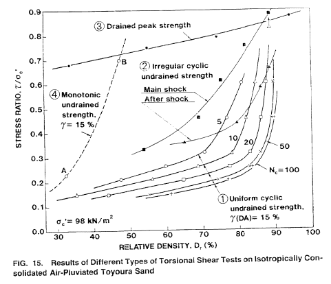

I work with liquefiable silty sand tailings deposits and the tailings industry is starting to understand, due to all the failures of late, that you can't assign a friction angle to saturated very loose granular material. A comparison for the shear strength of granular materials related to relative density is illustrated in the chart below.

If I have a PSD that confirms that the material is granular, i.e less than 30% fines and Atterberg's confirm that the little fines there is are plotting as a silt and not a highly plastic CLAY, then I blindly assign 28 degs. My reasoning is as per the graphs above, many of the greats did not include lower than 28 deg in their graphs.
MTN your reference shows for an SPT of 1 in rounded uniform sand, Dunham would give a phi of 23 degress = (12*1)^0.5+20. Do you honestly believe that?
