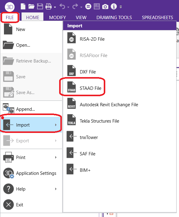

Hello everyone,
I was wondering if you are able to import a Staad pro CE model into RISA 3D. I only need the geometry model to import to RISA 3D , I can just input the load cases myself.
Thanks in advance!
I'm familiar with Staad Pro, but I don't know what the CE stands for?
RISA added a STAAD import utility into the program decades ago (before I even started working there). It was based on the Text file format used for STAAD-III. It hasn't been updated much since then. But, I believe it still works pretty well with STAAD Pro files.
The way I know how to do it is use the File - Import - STAAD File as shown in the image below:
