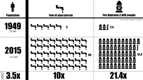

I don't think the problem is whether we can maintain individual bridges, buildings, etc. It's how we will pay for maintaining all of them.
One big area of concern is the amount of civil infrastructure - streets, water, sanitary sewer and stormwater pipes, treatment plants, fire and police stations, schools, and so on - needed to support suburban lifestyles. Compare the revenue they generate to the maintenance costs. I strongly suspect the ratio will be less than one. How much longer will this be sustainable? Will we have to triage neighborhoods? If so, how?
This chart represents the change in infrastructure per capita in Lafayette, Louisiana before and after suburbanization. Yes, now we have more durable materials than clay pipe and tar-macadam, but it still shows an increased burden in infrastructure costs per household.
My glass has a v/c ratio of 0.5
