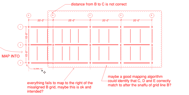

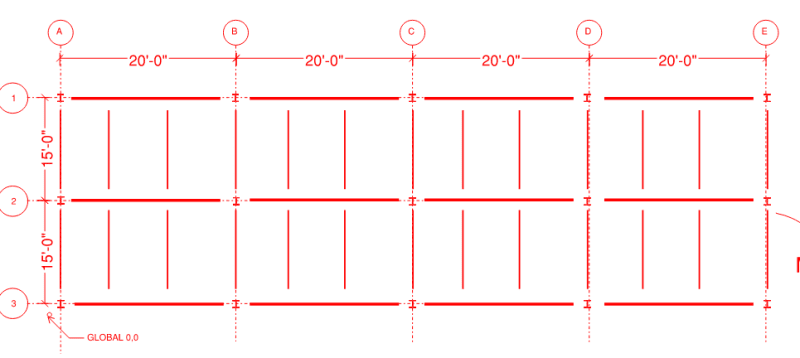

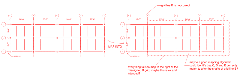

I am on the hunt for mapping algorithms to link structural engineering software beams and columns to revit beams and columns.
The problem:
Often our revit models and engineering models are located at differing points in global space and maybe even rotated. I want to be to map the two models together with some form of a tolerance.
See image below:
I have written some sloppy code previously to tackle this problem, but it requires manual input for mapping the global coordinates between the two programs and could not handle a rotation type parameter.
Also, if one of the gridlines gets significantly off (say 3'-0" or more), the sloppy mapping algorithm falls apart and flags all other elements as being out of sync. Maybe a good mapping algorithm could tackle this, flagging the offending bay, and then mapping correctly the remaining bays beyond?
Anyways, the end goal is to map beam and columns from one piece of software to another, with a robust mapping algorithm.
I am fine with sticking with 2d if need be, but the end goal would like be a full 3d solution. Assume that all grid line locations are known between the two pieces of software and all beam/column coordinates are known.
Are there any famous algorithms for mapping points between one "system" to another "system"

This system falls apart in the second example I posted though, with the bays beyond the misaligned grid line all not mapping. Maybe this is intended? If I could get a more robust algorithm to match grids C-E that would be awesome, but probably a much more in depth solution.
Posted again for reference:
Original Space
Mapping Space - B to C gains 5'-0" from the original space, causing for a flag of all beams beyond column line C

yeah that wouldn't match in my approach because the structural model and Revit model are off entirely by 5ft horizontally beginning at grid B.
If this was a simple modeling error where grid line B was just shifted such that A-B was 15 ft and then B-C was 20 ft then it would work because C-E would be in the right relative locations, but what your screenshots show is a complete lack of coordination between the design and drafting models.
For modeling discrepancies of that magnitude I don't think mapping is the way to go as the coordinates won't really every match up. This is where you'd need some kind of unique identifier and a database to keep track of the elements (if I recall this is what a lot of analysis software -> Revit links are doing to manipulate element positions bidirectionally).
