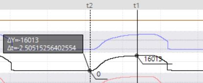

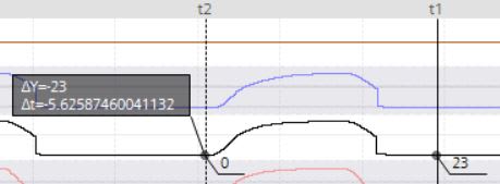

Another thing I did suggested just to see how it would impact the acc deacc speed was to change parameter 21.01 Vector start mode, which now it is set to Const time 500ms which is default to Automatic not sure whether that can cause any damage?
