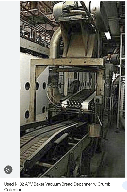

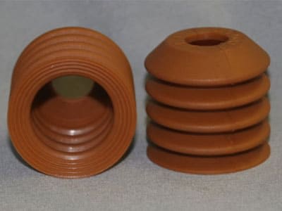

While I can't comment on your issue, it is interesting, that back in the 70's, I worked for the company that held the patent on using accordion-style vacuum cups to pick-up food products. If you picked-up a box or light bulb you were OK, but if you picked up any sort of food product, be it manufactured as in 'baked' like your 'biscuits' (AKA cookies), or something natural, like eggs, then you owed our company a royalty. Note that we manufactured bakery equipment including bread depanners (for taking a freshly baked loaf of bread out of a pan), and so we chose to use a moving belt of vacuum cups, which we developed to grip the top of the loaf without damaging it and thus was born the accordion-style vacuum cups, which we patented. The joke was that often we'd make more profit if a competitor sold a vacuum depanner then if we sold it, because they would have to pay us a royalty and when the customer had to replace one or more of those vacuum cups, because they would get damaged or worn-out, we'd get a cut of every one sold. Good business if you can get it (I'm sure the the patent has run out by now).
Here's what one of our bread depanners looked like:
And a close-up of the cups:
