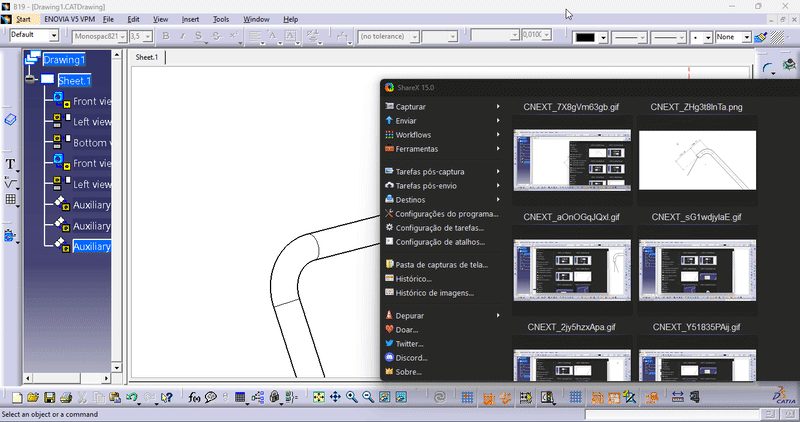

I need help on how to represent a cut on a tube in the proper way.
There are two parts involved. The first one is the truck rooftop, and the second one is a hanblebar (tube) for the driver to hold his hand and take a look at the cargo he is carrying. Like this one:
There is a cut on the tube that originated from a plane that was extracted from the roof of the truck.
It is a built plane on the roof, but it is a dumb plane on the tube.
How do I rebuild the plane using the angles and axes of the tube's coordinate system? I'm asking this because I'm thinking of making 2 auxiliary views to show the real dimension of the cut.
I made a video that might help you understand the issue a little bit better:
I also attached the files that I made at home that resemble the real files.

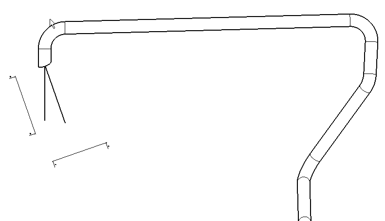

Step 1: Create a projection that shows the last bend as a planar - the two axes parallel to the viewing plane and showing the true angle between the last two segments.

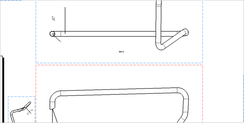

Step 2: Create a projection from the Step 1 view showing that last segment of tube in a direct end view and the next to last segment heading off in some direction.
Step 3: Create a projection from Step 2 showing the cut in a flat-cut side view to show the true angle of the cut. You label the projection arrows with a dimension to the next to last segment.
Like this?

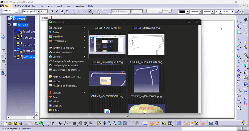

I don't understand it.
Is it like this below? I mean, a 90º projection of the first plane?

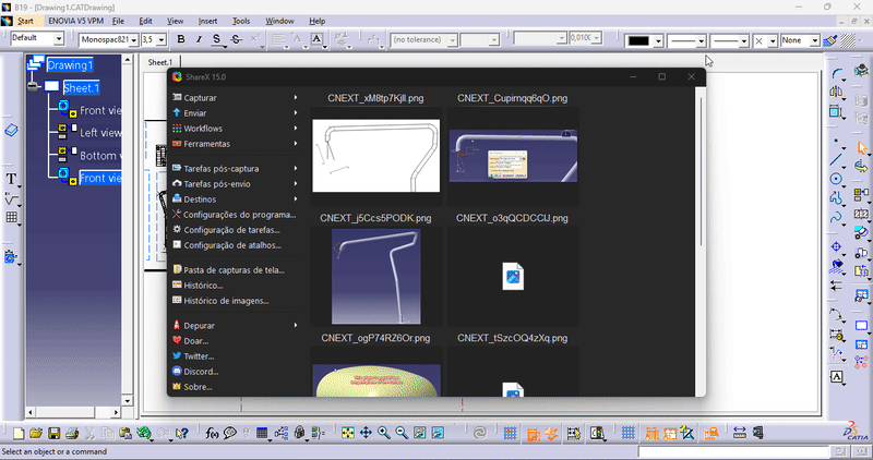

Like this?

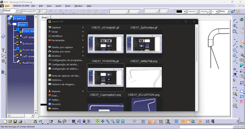

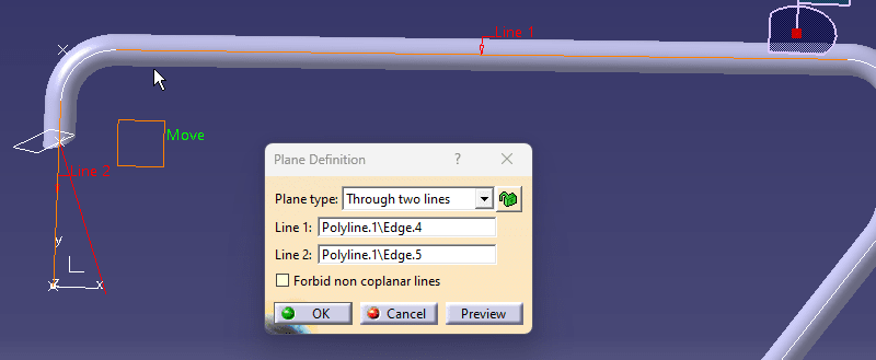

But now I need to relate this new plane to my original coordinate system for the tube.
I think I can do this:
1- auxiliary view from my front plane using the normal to the plane created on step 1.
2- make another auxiliary view using the same normal in order to reveal the plane that was created on step 1.
In this view, I can show the true dimension from my last point (or the one before it) to the center of the elipse.
3- I redo step 2:
4- I redo step 3:
Thank you very much, Dave!

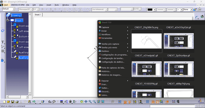

The second step is a plane that is normal to the pipe axis, showing the true diameter of the end of the tube. That would appear vertical in the second image.
It's more like this, then:
Therefore, Step 3 would be this:
Is that right now?
