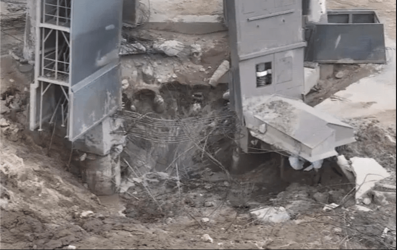

The above photo was from a youtube video showing the reinforced concrete supporting structure of the SpaceX rocket before and after the yesterday's launch when it exploded 4 minutes into the flight.
It appears the RC slab was flush as one level prior to the launch but now has the ground beams exposed. The video also claimed there were concrete fragments flying all over the place as shrapnel damaging some fuel and water tanks.
There seem to be at least the following issues in play:-
(1) The "disappeared" reinforced concrete slab was totally unsuitable for its purpose. I do not know if it was reinforced or not but it would have been criminal if it wasn't.
(2) The reinforced concrete columns and ground beams show little damage. This would suggest the reinforced concrete in adequate dimension could be the suitable material for the structure including the slab if adequately shield from the high temperature heat.
(3) Had any of the RC column or ground beam failed during the last launch the supporting structure might not have remained static then the rocket could have shot off at an angle other than vertically upward. Consequently a huge disaster could occur if the rocket hit the population with the amount of fuel it carried.

Scott Manley's analysis is good. Rapid unscheduled digging threw concrete around, which destroyed several engines. The others that failed may have also been damaged, and just took longer to completely stop working. The rocket lost (at least some) attitude control, was too low to separate, and eventually the flight termination system blew it up.
There's a good picture of the concrete having been stripped completely away from the rebar. They definitely need a flame diverter.

This is a new product to me, it seems to have characteristics useful for this application, but as a main engine flame target it needs to resist stagnation temperature which must be much higher than 1100C, the field test proves it is not enough.

It is the out of sight edge case of Temperature, thermal shock, mechanical shock, jet velocity, and water impingement that makes it not work.
I suspect most flame chutes protect the refractory material from encountering the hot jet by ensuring there is a layer of steam between them. Then the refectory only needs to handle radiant energy from the jet.
I would guard against the use of the proprietary "Fondag concrete" as a structural material to withstand 1100C. It appears its property to withstand 1100C may as a refractory shield and not necessary as a structural element to resist compressive load and abrasion.

Thus in a nuclear melt down if the concrete were to remain as a structural element the temperature permitted is less than 343C. Fondag concrete may be applied as a shield over and above the structural concrete but can it bond to it under severe pressure and heat without being blown off is a key design consideration too.

The exhaust should never directly impinge on the concrete.
