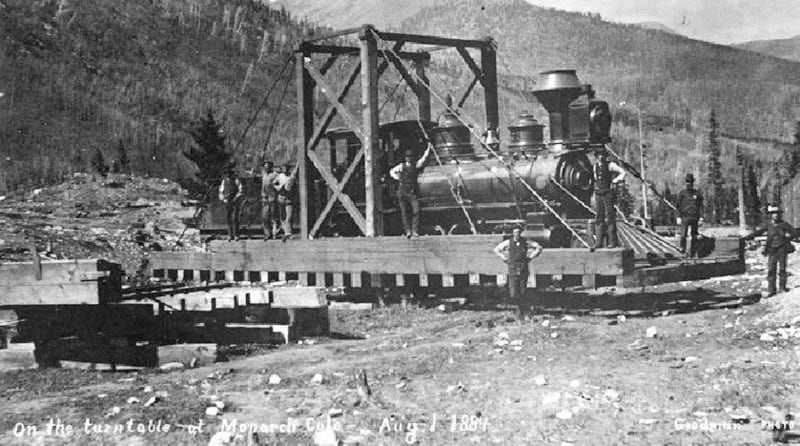

Railroad turntables support track that can be spun around to align with various radial trackage.
At first, they had only a center bearing. This meant that the locomotives had to be perfectly balanced before the turntable was turned (much like a swing bridge).
Fairly quickly, a ring rail was added out at the ends of the turntable bridge, along with wheels. Thus the need for perfect balance was eliminated.

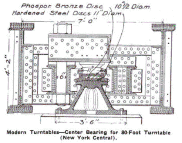

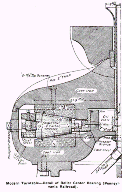

Incidentally, I've see drawings of the center bearings. All the ones I saw were tapered roller, arrayed in what I think of as a vertical loadbearing pattern. I read also of plain bearings. I suspect those were used in lighter duty versions.

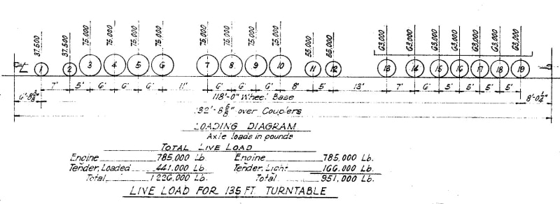

While the load of train engine may be centered over the center bearing, the loading pattern on what amounts to a 2 span continuous beam is out towards the middle to outer ends of the spans, where the wheels of the engine bear on the beam. The beam is not even close to being rigid. It bends and deflects, and distributes the load to all 3 support points, based on where the loads are on the beam.
Anyway, turntables are mostly for tourists now anyway. Modern train engines can and do run 'forward' or 'backward' just the same, so there's rarely, if ever a need for a turntable anymore.
Distribution of live load for 135' turntable:
spsalso
Note that my loading example is 30 years later than the examples posted by SlideRuleEra.
They do show the typical design of 1907, I think.

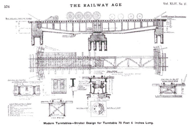

From the 1907 documents:
"Such heavy weights and long wheelbases require very strong and stiff girders for the turntables..." NOT flexible.
"The rocking surfaces are so designed that the load must be symmetrically distributed under all conditions." This would mean that there would be no need for outer bearings or ring rails, since they would never be loaded.
And yet, there they are (railroads being notorious for spending money on silly little nothings).

The wheel loads will be distributed to all 3 support points. The beams under the turntable would have to be much larger and heavier if it did not have a support in the center, and they apparently been working well for many decades.
<- no drive wheels at all
<- drive wheels aren't the support wheels. Not shown but I would expect a large spring to push the drive wheel against the weight of the bridge and any payload
<- another foot/hand turned turntable, though one comment indicates the small pit has a pedaled arrangement. I like the little bump from the mismatch in height plus the small gap.
Everything is flexible.
...including the beam. This is the key. It's a 2 span continuous beam that bears on all 3 supports. With a typical engine all the way on the turntable, there will be nearly as much weight on the ends as the middle.
