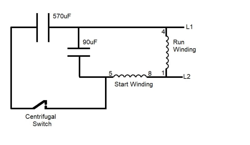

My son brought home from his workplace 4 AC capacitors used on the motor of an air compressor.
The air compressor will not spin but is trying.
There has been a wire that shorted against the case of one of the 50uF caps, this did burn a hole in the case and some of the oil leaked.
Since the cap measures the correct value, I wonder if that is the problem.
Could the cap measure perfectly fine, but not work under load at higher voltages than the Cap checker?
The wiring of the 4 caps seems quite odd to me, two 50uF caps in parallel and two 1150uF caps in series and then these are in series. I'm thinking it was a repair, BUT, my son says the 4 caps seem to fit in the original enclosure.
I'll post a drawing of the way the caps are wired below.
BTW, If the cap wiring makes since, can some draw or point me at a schematic to show me where the 3 wires go in the motor? (T5, T6 and blank)
Thanks, Mikek
P.S. I'm kinda wondering if the centifugal switch is open, and the start winding is not energized.
We will replace the leaky cap as the first attempt.

The caps have been replaced and it did not fix the problem, I'm saying check the centrifugal switch.
However to I'd like to know if I have any understanding of the motor operation.
Here's the general schematic.
When power is first applied the Centrifugal switch is closed, all the current for the Start Winding must go thru
the 570uF and the 90uF capacitor, this causes a small phase shift, when the motor gets close to full speed, the centrifugal switch opens
and the current for the Start Winding flows only in the 90uF cap causing a larger phase shift.
OR, is the phased shift unimportant and it is just the higher current in the start Winding when the Centrifugal switch is closed
(because of low Xc)and then in run (when the switch is open) it has a lower current reduced by the higher Xc of the 90uF cap?
Thanks, Mikek

I understand reactance causes a phase shift, I also understand when the centrifugal switch is closed the capacitors look like 4Ω in series with the start winding and when the switch opens the capacitive reactance increases to 29.5 Ω in series with the start Winding.
So, when the motor is starting and the switch is closed, the current through the start winding is higher because of the reduced reactance of the larger capacitance, and then, when the higher torque to start the motor is no longer needed, the lower reactance (larger capacitor) is removed (switch is opened) and the current in the start winding is lower for run mode.
I guess my confusion is about the phase shift. It may be that the phase shift is small and not important to the motor operation and it is just the series reactance that alters the current depending on if the switch is open or closed.
But it could be the phase shift that sets the direction of rotation.
Any thoughts?
Thanks, Mikek

EDIT, reading part of the PDF, page 7 describes the motor I'm concerned with.
My question, after the motor has started and hits 75% of rated and speed the Centrifugal switch is open, the start winding is still energized through a smaller capacitor.
Is the smaller capacitor still required, to produce a phased shift? Is a phase shift required at this point or would the motor run OK without a phase shift and the cap is simply there to reduce the current on the smaller wire gauge used for the Start Winding. In my case the 100uf capacitor has 26Ω of reactance, That limits the start winding current to 9amps, but it is even less because of the start winding inductance adds vectorally to the 26Ω.

The starting winding is left on the circuit as per the drawing posted by the OP. Only the additional starting capacitor is switched off when the motor reaches full speed.

The diagram is correct for a CS/CR motor, and yes, the AUX winding remains in the circuit, only the Start Capacitor is switched out. But if the centrifugal switch is stuck open, it will not start with just the Run capacitor in place, you need the phase shift caused by the bigger cap. That's the usual failure mode, because the motor was up and running, when some sort of crud or debris got into the centrifugal switch so when they shut down, the contacts never re-closed. Seen it many times. You might try spraying come contact cleaner into the NDE bell where the centrifugal switch is, then tap it with the back of a screwdriver for a few minutes. Beyond that, you need to disassemble the motor to get to the centrifugal switch.
The problem was the contacts of the centrifugal switch. I theorize and it's probably right, that a wire shorted against the housing of one of the capacitors, Clear signs of this, a hole burned in the case of the cap and oil leaked out. When the wire shorted, this produced an over current and burned the contacts of the centrifugal switch. The two contacts of the centrifugal switch are in series, it just happens that there is a spade lug
on the switch assembly that allowed bypassing the burned contact. So the wire was moved to bypass the burned half of the centrifugal switch and the motor works fine. Although the leaky cap was replaced.
Thanks for the help, Mikek
