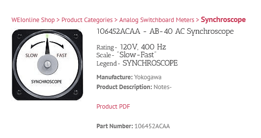

For manual operation a synchroscope.
For automatic operation, a sync check relay.
There are advantages to a synchroscope and a sync check relay may be added to a synchroscope.
Three parameters must be within limits for successful paralleling.
Voltage, frequency and phase relationship.
Phase relationship is by far the most important.
A synchroscope has a single pointer capable of continuous rotation.
The RPM of the synchroscope is directly proportional to the difference in frequency of two sources.
Historically, best condition for closing the paralleling breaker is not equal frequency, but with the incoming set running at a slightly higher frequency. This allows the incoming set to pick up some load and avoid inadvertent reverse power trips.
When the sets are at equal frequency, the pointer will be stationery.
To synchronize, the speeds are adjusted until the pointer is rotating slowly clock-wise.
When the pointer is at 12 O-clock, the breaker is closed and the incoming set picks up some load.
A simple sync check relay will prevent serious mistakes, but will not be able to mimic the action of a skilled operator and a synchroscope.

Synchroscopes work in a very narrow band of frequency. Won't work at aircraft frequency of 400 Hz as also standard 50/60 Hz protection and measurement systems.
This is a safety issue. I don't think it's a good idea to trawl internet seeking to troubleshoot custom designed custom built electrical machines.

The oscilloscope will work at 400 Hz.
I understand that we can't suggest hacks for installation in aircraft.
I don't think that using an oscilloscope for troubleshooting on the ground will be an issue.
I think that it is safe to assume that there is aircraft specific synchronizing gear installed.
The principles of parallel operation are the same regardless of frequency.
Speed control must be about 8 times closer at 400 Hz.
How to trouble shoot problems with 400 Hz relays and equipment? One method is the oscilloscope.

Or this:
