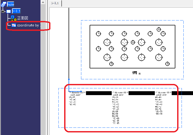

Little Cthulhu do you have any command to find them? tôi đang muốn tạo một macro như lệnh " hole dimension table" của catia
No, you can't find generated geometry by type (circle, line etc.)
is there a way to select the circle?
hoangthe.
You can find the circle by Isolating the link.
This is not a very pretty method, but here is an example of temporarily copying and pasting a view, Isolating it, and then deleting it once the necessary information is retrieved.
A new view is created near the origin, and the result is text for each diameter.

kantoku
Thanks. I see this code select all arcs (not closed circles) how can only closed circles be selected?
hoangthe.
Rewrite the get_circles function next and add the is_close_circle function.

kantoku.
thanks for your help, it's great
Sub CATMain()
Dim drawingDocument1 As DrawingDocument
Set drawingDocument1 = CATIA.ActiveDocument
Dim SelectionsAll As Selection
Set SelectionsAll = drawingDocument1.Selection
For Each RefView1 In SelectionsAll
Dim Elements As GeometricElements
Set Elements = RefView1.GeometricElements
For Each Element In Elements
Select Case TypeName(Element)
Case "Axis2D":
MsgBox "Axis"
Case "Line2D":
MsgBox "Line"
Case "Circle2D":
MsgBox "Circle"
End Select
Next Element
Next RefView1
MsgBox "Finish"
End Sub
