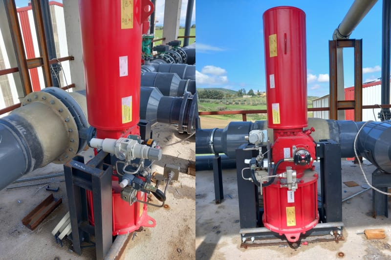

I am attaching photos of a valve the likes of which I haven't seen before. Anyone witnessed this stuff plz share some reference links
It's a butterfly valve equipped with a spring return / ESD actuator.
Looks like an on off valve to me and with that size spring quite a large DP, but is on /off.
What sort of "details" are you looking for?
Your photos are focused on the actuator. Focus on the valve in the line, and you'll learn more details, like Make and Model.

This is a %valve not an on/off valve. Its on Cl2 line that operates at about 200mbarG (~3ton/hr at 85C coming out of electrolyser)
I want details regarding working principle of such a gigantic actuator. In my previous proj3cts of similar kind I have not observed such. What is the need of an ESD actuator?
IOMcube
Is there some other valve in line which is actually doing the control because that looks very much like a ESD valve to me - Pneumatic spring return as written on the actuator itself is, IME, not used as a variable control. Too difficult to get the air pressure vs the spring resistance, plus a butterfly valve isn't great at control.
Got a P&ID of this system?
This is a fail safe ESD actuator which closes under spring power if the air supply fails or the signal holding the valve open goes to 0V during a process trip or ESD initiation.
It looks ridiculously big for 200mbar and suspect someone found an old one somewhere and just bolted it on.
That is a big, honking actuator for a 3 psi dP. I suspect LI is right; it came out of the bone yard.

Valve appears to be a rubber lined, double-flanged, concentric butterfly.

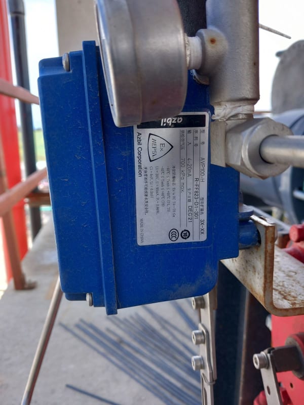

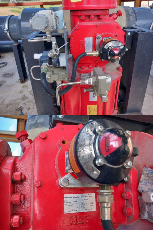

I am not so convinced this is an ESD valve. I see some components in the instrumentation that indicate it may be a control valve. There is a filter regulator. A volume booster that is fed from what looks like a positioner (blue colored item). the positioner looks like it may have a pressure gauge on it. Top picture shows what could be a feedback linkage from the actuator to the positioner.
Single-acting actuators are common for control valves as the response are more stable than double-acting.
This very well may be a butterfly control valve. Just need the name or a picture of the tag on the blue covered item in the assembly. That will prove if it is ESD or control. Cannot tell if it is ESD or control from just the actuator alone.
I can see that there may be some sort of positioner feedback alright, but the size of the units still looks massive compared to the required torque for a butterfly valve.
Needs a FO capability though so some sort of spring action is required.
Got it now. Thanks. It's low pressure, so the CV is big. Because the CV is big, it's a butterfly, because they are cheap. Not the best at fine control, which may not be needed in this case, but they are definately cheap. Looking forward to CV picture. Get the nameplate.

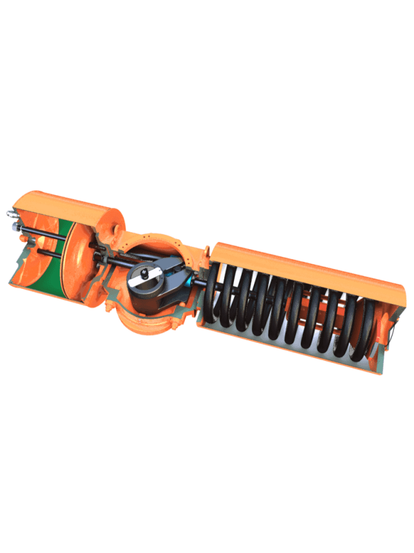

As others have stated what you have is a single acting spring return pneumatic piston actuator. Bottom cylinder contains the piston, top cylinder contains a big spring that provides the motive force for fail closed (or open) operation. % open is dictated by the pressure under the piston, via a positioner for modulation or a simple solenoid for on/off. Bettis G Series is a well known example if you are looking for more detailed representative/example vendor information.

I am uploading additional images. The text was all Chinese so I need to translate
This is the positioner image refers to %valve (PV216)
This image refers to on/off valve (ZV219) which is at downstream of above valve ...similar looking
The left side spec sheet refers to %valve (PV216) while the right refers to on/off valve (ZV219)
(My image resolution was downgraded so I am using external server)
In the spec sheets above I found no reference for ESD actuator stuff
I think the issue looking at the data sheet is that the valve is rated for 10bar differential (1.0 Mpa) and the actuator may have been sized according to that. I don't know what the opening and closing torque figure is for those sorts of valves, but it must be quite significant to get them to use such a big actuator.
The ESD bit is dependant on how you use it and how the control equipment is certified for operation. If you specify a fail closed or open valve then you need spring power to do this if the air supply fails. These can be straightforward on/off isolation valves, but physically there is very little between that and the same valve designated as an ESD valve. Normally ESD valves just run on a different control circuit and can't be used for process isolation or normal operation, but that's not actually written in a code AFAIK.

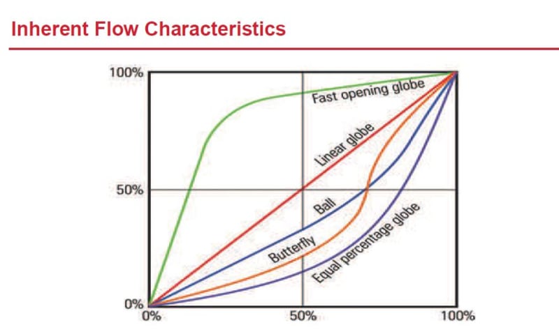

Equal percentage valve characteristics can be achieved using butterfly control valve? I thought these show only linear characteristic.
Secondly I have learned that butterfly useful control is b/w 20 - 60% valve opening. Is my experiences correct? Bcz currently I am calculating what %open my valve will be at 3.6tonne/hr of saturated Cl2. I have graphs of water quantity in saturated Cl2 at different T&P
Looks like roughly 0-60% open is equal %, and 80-100% open is linear. Can you get the Cv vs. % open curve for your specific valve(s)? Equipment file? Mnfr?
