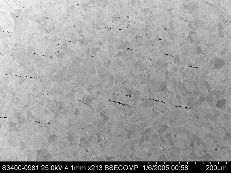

Anyone here work with 625 regularly that could comment on whether a microstructure we are seeing is normal/typical?
We have not etched yet and are using BSE and EDS on the SEM to differentiate phases in a polished specimen. We don’t have EBSD so the identification of phases is a bit loose. We do not appear to have laves phase, but we have some relatively large Nb-rich intermetallic stringers that are not on GB’s. I am not seeing these in the literature.
This microstructure seems atypical and potentially problematic from a fatigue/ductility standpoint. This component was relatively low stress (5 ksi), low temperature (200F), and in a reatively innocuous environment (air). It suffered a brittle failure with almost no ductility. The component had about 15% CW and for some reason we can’t figure, was not annealed (based on hardness and microstructure).
If anyone has expertise, I will post or PM the images.

do you have a COA to see if the carbon content high? if you are certain there is no Laves phase (most detrimental to ductility), the culprit is probably NbC which formed at the end of solidification, very stable and hard to be eliminated at solution. 15%CW could lead to pre-existed cracks perpendicular to the Nb-rich bands.

MagBen and EdStainless: I am unfamiliar with the acronym COA. We plan to do spark OES to get accurate bulk composition data once we get approval to excise and flatten a sufficiently large piece of material. I have attached a BSE (compositional contrast) image of the LT plane. The small white/bright particles at GB's appear to be metal carbides based on EDS. Occasionally, we will see higher Si, ostensible a lave phase, but that is not widespread. I am not sure how I would go about differentiating lave phase without EBSD. The dark stringers are what stood out to me as a red flag, mainly because I have not seen anything on this scale in the literature.
EDS scans of the dark particles are "odd". They are very rich in Ti (the most abundant element in this phase, >30 wt%), rich in Nb (compared to matrix), poor in Mo (compared to matrix), AND rich in Nitrogen?? Due to the nature of EDS, I am always careful with light elements that have single peaks overlapped by a heavier elements. In the case of Nitrogen, its peak overlaps heavily with the first peak of Ti. I have seen absolutely nothing about nitride intermetallics in 625, so I am inclined to exclude Nitrogen manually from the EDS analysis, as it is likely just titanium that is being misidentified due to the peak overlap. Interested to hear your thoughts on this. Am I missing some relatively common processing mistake that would introduce nitrogen and nitride inclusions, or is this obviously a peak overlap error? We have ultrapure argon hooked to the OES for analyzing very low nitrogen in lean SS, so if N peak is not an error, I am hoping it'll pop again when we do OES.

Suspect the white/brighter phase was Laves, while dark particles carbides/nitrides. Heavier elements shown in SEM brighter, lighter be darker.
Ti loves N, you may not want to exclude nitride.

I wonder if the stringers are actually oxides (slag, trash) from the melt and cast.

Titanium nitrides and carbonitrides are easily identifiable by their morphology and color when observed under an optical microscope. The nitrides are golden-yellow and the carbonitrides more lavender-like.

I am going to investigate the white particles further to try and discern between laves phase and carbides. We were seeing high C signals, but looking at our matrix readings I am starting to think we may have some carbon surface contamination. I'll ultrasonicate it briefly in alcohol and try EDS again.
Would the titanium nitride particles be yellow in the as-polished condition, or, after etching. What morphology would be expected? Blocky? I will have a look on the light microscope and see what sort of contrast I can get in the as-polished state.
I will look into tint etchants that may help me distinguish between carbides, nitrides, and gamma' or gamma'' (can they get this large if grossly overaged?)
Titanium nitrides are easily identifiable even in the as-polished condition (bright yellow cubic). In the case of titanium carbides, they are greyish-lavender with a more irregular shape.
In any case, what is observed in the image does not appear to be any of them. You will probably find some of them (in almost all titanium stabilized alloys they are found) but, in my opinion, not in that quantity and grouped that way.
The particles were yellow on the optical scope so I guess the EDS Nitrogen signature was not erroneous. Makes sense as well that they are dark on the BSE detector due to relatively low average Z.
Unless someone would like to chime in with information on how titanium nitride stringers on this scale would be acceptable/normal, I am prone to label this a material manufacturing defect. I'll let the manufacturer dive into how it happened. It explains quite reasonably the multi-site fatigue damage that preceded the brittle failure.
