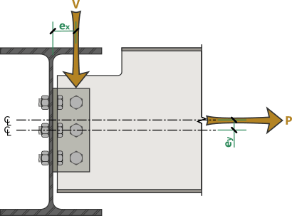

I am designing a double angle connection between a floorbeam and a girder web on a bridge. The floorbeam is coped, has a 6.5" eccentricity to 15 bolts 3/4" A992 bolts spaced at 3", and has a load of 308 kips at the girder. I am having some trouble coming up with the required strength, T. Can I extrapolate T from the moment created by the eccentric point load? Would I even need to account for the prying action in this case?

This is just a single row of 11 A325 bolts. I am talking about the bolts between the column and the angles. I was failing for prying in the angle > I upped the angle size > then I was failing for rotational ductility > I ended up eliminating the eccentricity by removing part of the existing structure. I got T from the following equation that RISA Connection uses, but I'm not sure where it's found in AISC: Me = V*ex + P*ey & Tbolt = (6Me/(b*d^2))*At*keff & T = Tbolt + P/(n*b).

The procedure for calculating the worst case bolt tension caused by moment due to eccentricity is borrowed from Steel Structures: Design and Behavior, 3rd Edition by Salmon and Johnson. In this procedure, the bolt tension due to moment is added to the bolt tension caused by a pure axial force to come up with a total required force.
To calculate the axial load due to moment, we assume that the plate or clip angle acts as a solid rectangular beam in flexure. The flexural stress at the bolt row furthest from the center is then multiplied by the tributary area of the bolt (At).
Coefficient Correction Factor, k_eff
Because our bolts do not connect to the extreme fiber of the connecting plate or clip angle, we use the k_eff coefficient to scale back the calculated value of Tbolt to be exactly that at the location of the bolt.
That's where Tbolt = (6Me/(b*d^2))*At*keff comes from. (Refer to "Steel Structures - Design and Behavior" by Salmon and Johnson for a full explanation.)
Me = V*ex + P*ey is just the moment due to the eccentricity of the shear and axial loads (see graphic below).
