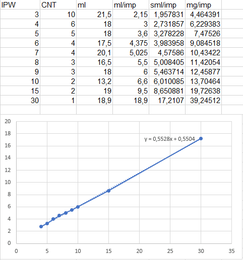

I Continued to find what's wrong.. I tested the dynamic behavior of the injector on the target system - replaced the vapor LPG supply to the injector rail by a pressurized air with a constant pressure and remove the outlet hose of one injector from the intake manifold fitting and measure the delivered air volume. So the same ECU, injector, wiring harness.. The air volume have been measured using a classical lab method - to release the air into the graduated container under the water and keeping the water level equal. Conditions were:
Absolute air pressure in the rail: 196 kPa
Barometric pressure: 96 kPa
Ambient temp: 12° C
Supply voltage of ECU: 14.0 V
Where:
IPW = Injector pulse width
CNT = Count of the pulses
ml/imp = measured air volume per one pulse at 12° C and 96 kPa
sml = measured volume per one pulse recalculated to 0° C and 101.325 kPa // sml = (ml * (273.15/(273.15+12))*(96/101.325))
Results:
Static flow is 0.5528 SLPS (standard liter per second)
Offset is -0.5504 ms .. This is a bit strange to see a negative offset. I think it means that the open time is shorter than the close time. There is a peak&hold type injector.
However, to deliver above mentioned 3.196 sml of the gas, I need to open the injector for (3.196 - 0.5504) / 0.5528) = 4.786 ms .. Looks plausible compared to above calculated 5.836 ms, since the injector manufacturer does not specify a dynamic behavior. They specified just complete open time, complete close time and static flow. This means the above calculation does not consider that the gas flows also during opening and closing phase of the injector.
But, still don't know why my engine needs 10 ms open time under this condition. :D

The pressure ratio matters, but in your example not really. As long as the ratio is about 2:1 or greater, sonic flow assumptions can be used.
Good idea. Thanks for that. Are we sure that the critical pressure is not reached? When idling, the pressure ratio is 140 kPa : 40 kPa = 3.5 : 1. I'll try to calculate tomorrow.

BTW, I agree critical flow conditions at the injector nozzle is the probable cause of your miscalculation.
je suis charlie
Hi Guys, I finally used the thermomechanics approach to solve the fluid flow through a nozzle and it gives me very accurate results. Thank you for your review and the crucial hint with a sonic flow.
