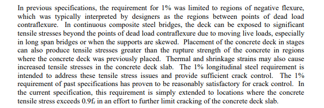

Steel Bridge Design Handbook Chapter 17 seems to indicate that it was a past practice to define negative moment region by the points of dead load contraflexure. It is relatively easy to find this distance from the piers.
Then the handbook goes on to talk about the tensile cracking requirements.
It is however, difficult to determine exactly up to what length from the pier the tensile stress in deck exceeds the factored tensile strength. So approximations like 25% mentioned by Bridgesmith is helpful, though it is not per the code.

Per AASHTO, 2/3 of the required 1% steel must be in the top layer and must extend a development length beyond the point where the tensile stress in the concrete due to the Service II load combination is less than 0.9*fr (See AASHTO LRFD 6.10.1.7). Depending on the DL to LL ratio, this may be more or less than the DL contraflexure point, but we've always found it to be less than 25% of the longer span adjacent to the pier under consideration.

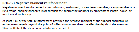

My thought would be 3 + past the inflection point would apply? Is there any reason why we wouldn't at least consider LL in your negative moment envelope?

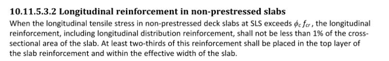

This is from the CHBDC. The Concrete Design Handbook has Figure N12.12 describing the clause.

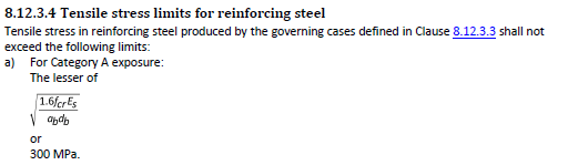

You would also need to check a particular section for minimum (and maximum) reinforcement per Clause 10.11.5.3.2 as you indicated and reinforcement ratio and cracking moment. The 2014 CHBDC used to also require you to check the crack width associated with your reinforcement, with 0.25 mm being the max crack width for a bridge deck subject to de-icing chemical. In 2019 they have changed it to a stress based check.
