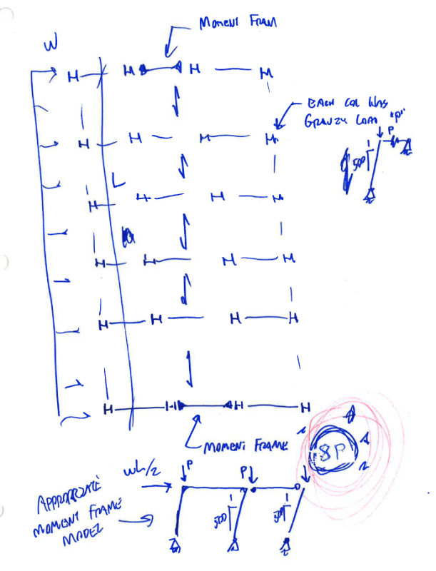

It is vitally important to recognize that:
1) For many structures, P-Big-Delta issues are critical even in the absence of any applied lateral load at all. Lateral loads only make matters worse, depending on the load casing.
2) Lateral systems usually stabilize much more gravity load than that applied directly to the lateral systems themselves. Note the significance of the [8P] in the sketch shown below. It should really be [10P] too.
As an experienced engineer, I sometimes allow myself to not consider P-Big-Delta when I am confident that my lateral systems -- including the diaphragms -- are stiff enough render P-Big-Delta insignificant.
I almost always consider P-Big-Delta explicitly for the design of:
1) Moment frames and;
2) Concentrically braced frames tall enough to exhibit meaningful flexural behavior over the height of the structure.
Put another way, I mostly only disregard P-Big-Delta when I'm dealing with stiff diaphragms stabilized by squat, more or less concentric braced frames. Helpfully, this encompasses a lot of buildings. When in doubt, calc it out. And when you're an EIT, make a point of always being in doubt.
