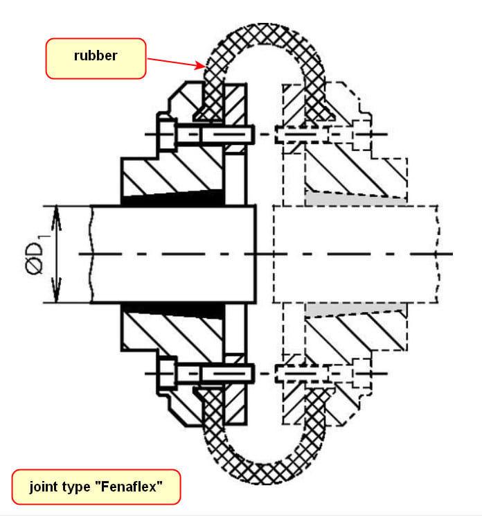

I am thinking about a coupling like this one.
I wonder what effect does the grease has on axiell shock loads since fluids cant compress. If one hub move 1 mm in the axiell direction. Would you get high pressure or would it just be high flow speed.
Hi Verkstad
The hubs shouldn’t move axially, the hubs are normally an interference fit onto the shafts.
Yes but if the shaft move the hub will move even with interference fit. I can not see that this cause a collision in the coupling and it will only happen when the engine isn't running.

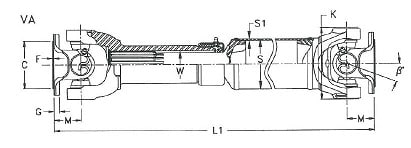

The Cardan shaft has a splines slip joint which is essentially a gear coupling. If your misalignments are manageable I would steer away from the high cost of a Cardan shaft.
