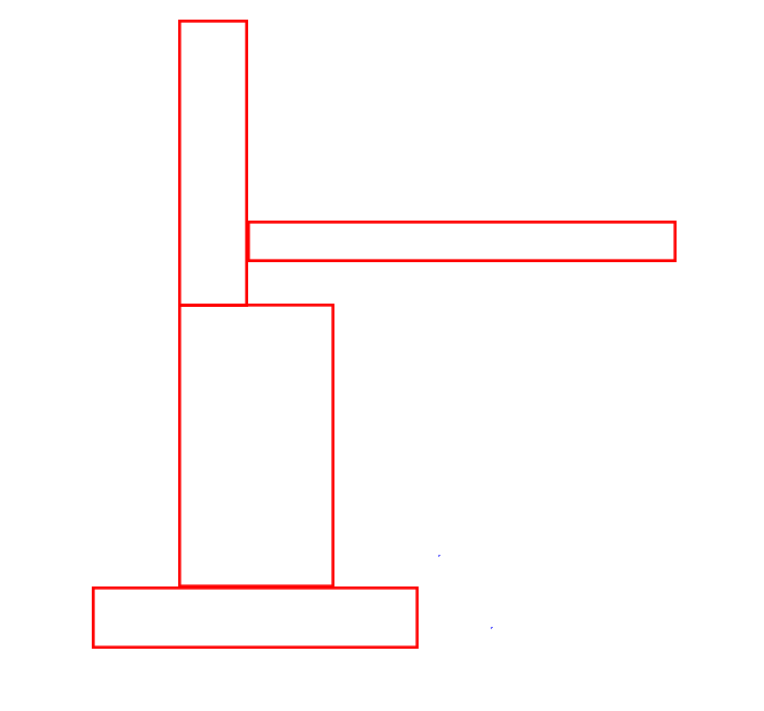

I have an 8 story concrete building with no cellar. The footings are 6' to 7' below grade (varies). Can the 1st floor slab be a simple 4" slab on grade? Or does it have to be a structural slab, like 10"?
My main concern is column slenderness. I'm afraid that if I use a 4" slab on grade, it might be able to laterally pin interior columns but not edge columns, thus making edge columns slender. Some of the columns will abut neighboring foundation walls, so they won't have soil confinement on one side, which leads to slenderness in that direction. The columns are all 12"x24".

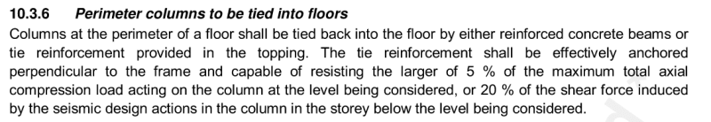

I was curious as to what our code (NZS3101) says about this, so here's the only relevant code snip I can find
I guess to be conservative you could assume that this value could occur in either tension or compression so you need tension tie steel and sufficient thickness/reinforcement in the slab for buckling
Oh yeah, that's a much higher value than the 2% we have here in hamburger and freedom country, or at least in New York. Anyway, I did check the tall columns for slenderness and it's still working, so I'm choosing to ignore the 1st floor slab on grade.

I don't know what the code provisions would say, but I would say basically if the slab supports walls or columns, or is connected to the walls or columns in a way that could transfer moment, shear, or bearing, it's a structural slab. If it's just 'floating' on on grade inside the foundation, it could probably be a slab on grade.
@ryaneng Oops, my math was way off. It's actually around 7.2 kips. Rookie mistake. Good catch!
@BridgeSmith When it's fully supported without needing soil, even if it is on soil, I consider it a structural slab. Since it's supported on soil without a way to transfer moment (though it could take some lateral shear), I consider it a slab on grade.
I agree. I meant to convey that in my comment, but apparently it was poorly worded.
