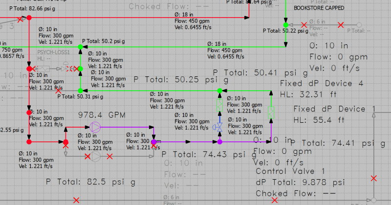

LittleInch - yes, the flow control valves in the buildings are all set to open or close based on the leaving air temperature of the AHU coils. I noticed in the software I am using (Pipe-Flo), if I replaced the FCV (does not really exist, just a stand in to 'force' a certain flow to a building) and its adjacent fixed DP device with simplified building loop (pump and one control valve with a fixed DP device to force a differential pressure, no difference is made on the loop. I.e. no difference on the building supply DP and the building return DP.

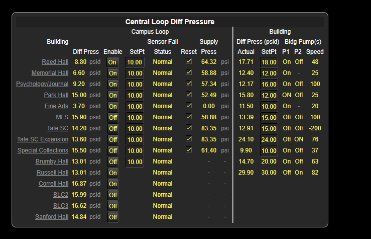

I am also uploading the a picture of how our BAS controls the district energy plants' pumps based on the building DP setpoints and also the building's DP setpoints that are achieved by in-building pumps. Let me know if any of this helps. I am also attaching a PDF of two things: one is a schematic of one of our campus chilled water loops and another is how that loop was modeled in Pipe-Flo. So you can see what was simplified.
