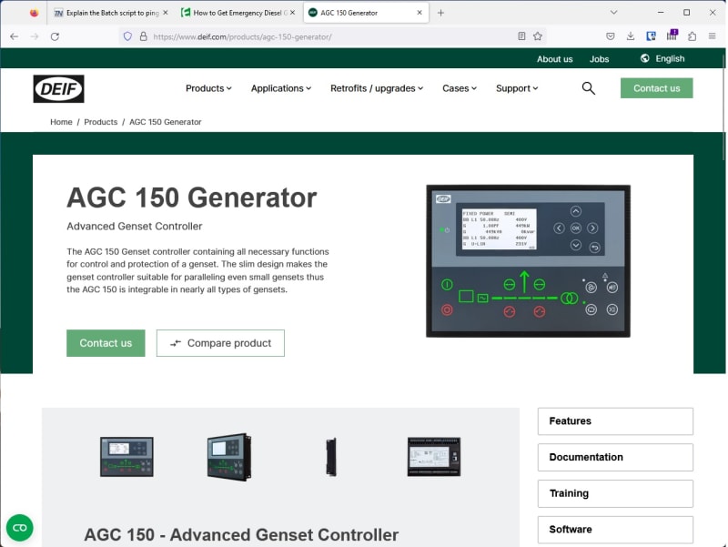

waross, in this case as IRstuff as alluded to, the Deif will likely handle mains failure, and can be configured to auto-start on loss of mains.
However, as you note, it either needs a separate ATS, or the Deif needs to monitor the appropriate bus and either trip the mains breakers or the mains breakers need to be fitted with their own UV elements.
The drawing indicated, if my memory of Deif terminals is correct, has no input for the mains volts monitoring (marked as ML1, ML2, ML3 with nothing connected to it). I also note that Deif has a number of AGC 150 models so this may be one of the lesser capable units.
The catch with this configuration is the mains detection in this type of controller normally has the load in between the gen breaker and the mains breaker, in much the same way as the Deif picture below.
For this context then mains monitoring would ideally be done on the Bus 2 side of the Bus Tie, with a UV element automatically opening the bus tie upon mains failure. Such an arrangement would prevent bumpless transfer back to mains though. This arrangement also prevents powering the normal MCCs from the generator as otherwise the mains monitoring will falsely detect mains if the bus is closed and powered by the generator.
There are implications as to where the voltage monitoring is connected and how the system functions, so it's worth taking a step back and ensuring that the functionality is as expected. Is this a marine application for an emergency bus as Tug guessed?

Bumpless transfer probably isn't the best term for what I'm referring to. The Deif units (I'm familiar with the older GPC series rather than the newer AGC150) are mostly capable of synchronising, hence the use of bumpless transfer. Fast Open-Transition as you note may cause issues.

They normally have a speed bias output in one form or another (CAN, 4-20mA, 0-5V etc) that will interface with whatever's on the engine, to be able to synchronise, and parallel load share with other similar connected units. There's obviously a minimum threshold for capability and in all my applications they've had it, lower spec mains fail non-synchronising units might not but I've never had a reason to look.
