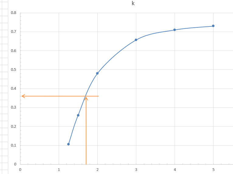

In the formula, the value of "k" grows when the ratio "a/b" grows. Which means that the maximum stress grows too.

ratio a/b: 1.70
value k: 0.365 (case 10, interpolating)

ratio a/b: 27.2
value k: 0.75 (case 10, extrapolating, it is asymptotic)

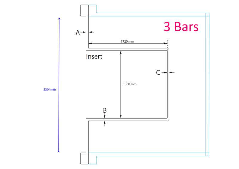

Now I would like to explain the case I am working on.
We have a chamber which has a section (we call it "insert") that goes inwards. Here an sketch:
I want to calculate the wall thicknesses A, B and C, so we divide the problem in 3 sections to support an overpressure of 3 bars (200 N/m2 pressure difference)
- Starting with A.
It is clamped in the outer perimeter (bolted on a flange). Aluminium 5083 (tensile strength 145 MPa)
a, Outer radius: 1152 mm
b, Inner radius: 680 mm
a/b: 1.69
k: 0.365
h, Thickness: (k * q * a^2/sigma)*0.5 = (0.365 * 200,000 N/m2 * 1.152^2 / 145,000,000 N/m2)^0.5 = 25.85mm
So the plate must be at least 25.85 mm. I'll add a safety factor of 3 later.
- For the thickness B. I'll talk later, since there is buckling involved
- For the thickness C, same than A. I assume the outer perimeter clamped (since it will be screwed or welded to the insert-cylinder)
With the new values of k I get a thickness of 21.87 mm
Are these numbers and assumptions right?

How much thicker will your flanges at the corners of this be?
If they are not a lot more robust then then will flex considerably and you may need to reevaluate your flexure case.
Short answer ;
- PLATE ( C ); Pls look section 16. Uniformly Loaded Circular Plates.
In this case , the edge neither clamped nor simple supported . Take the average of clamped and free case ( relevant formulas ,63 thru 66 and 69,70,71)
- PLATE ( A) ; This is also in-between case and superposition of center loading and uniform loading .
Center loading = ( the load is the reaction of plate C ) Average of case CASE 1 and CASE 6
Uniform loading = Average of case CASE 5 and CASE 7
My opinion..
