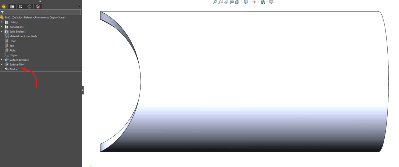

@3DDave and @ctopher, thank you both for responding. Normal to surface modeling for tube laser is something I've thought about off and on for the better part of year and tried a few different things - but for some reason (as it seems to always occur after hitting 'send') only now did I try using SW surface features.
With respect to the SW weldments tools, I have used those in the past, but I think all of their cuts assume some orthogonal cutting tool like a saw blade for miters and chops.
I made a simple bird's mouth cut in a round tube and it appears to be correct. I'm not totally sure how all other types of cuts and features would work but this seems to work well for now. I've attached a screen clipping showing the feature tree to see what I did.
Make outside surface, make your cuts using surface features, then thicken at the end.

Hi, ASIT859:
They are doable. You will need to use surface modelling techniques, like Surface/Radiate command. In mold or cold header, designers use Radiate command to create surfaces to split molds or cold header dies.
Good luck!

Hi, ASIT859:
I gave it a try. I see no issue of creating normal to surface cut. You just need to create 3d sketches on surfaces of your tube. And then you create surface(s) to split the tube.
If you want to do exactly (mathematically), then you will need to know cutting paths (rotation and feed). But that would be overkill for your purpose.

@jassco,
Thank you for the trial and for giving me the tip on the 3D sketch. I think that's what's most important. I'll play around with this later on when I have a chance.
@3DDave,
I did make an attempt on square tubing using the exact method I showed for round tubing and it looked awkward - so I think that precise method won't work for square tubing or perhaps angle. I think jassco's method would work, though.
Thank you all for tips and comments!
