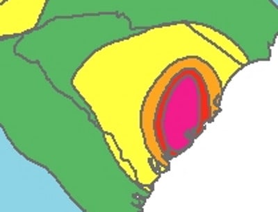

BigH - Risk of batter piles has been studied quite a bit in South Carolina because of our high seismic risk. We had to consider this risk when designing our generating stations, since some are located in the highest risk zone (see below).
Takes a good size earthquake to shatter a pile cap... a residential structure (like this thread) would probably be "trash" from other damage before then. Here is a 2012 paper by my alma mater for the SCDOT: "Behavior of Pile to Bent Cap Connections Subjected to Seismic Forces".
