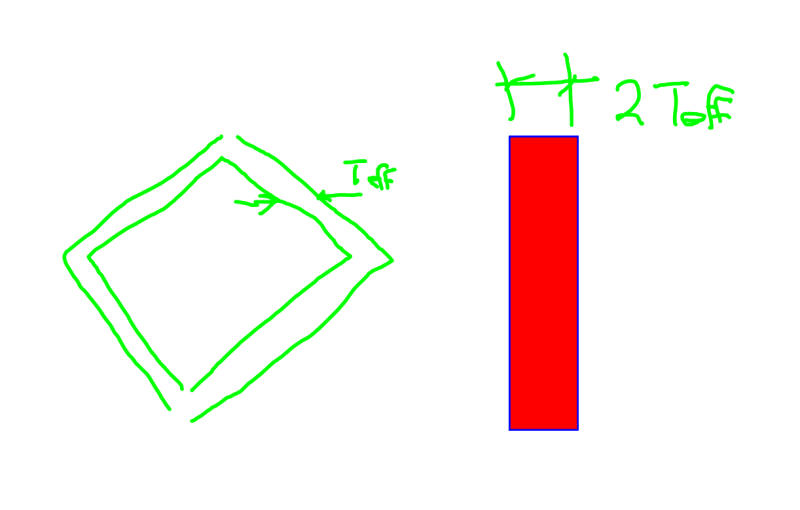

I am looking for help with finding the section properties of square HSS members that are rotated 45° (i.e. diamond).
I am using S16-14 to solve the moment capacity of an HSS beam, but I need to solve the Section Modulus (Z) first [Moment Resistance = (0.9)(Z)(Fy) , as per CL 13.5.a)]. The values given for the HSS members in Chapter 6 would not be correct with the 45° rotation.
I have run the rotated section through a design software called SkyCiv, but I have not managed to be successful in matching any hand calculations to those results.

An example on this would be an HSS 4x4x1/4 (CSA G40.20).
Z = 77.45 x 10^3 mm^3 (@ 45°), but I am not sure as to the hand calculations to verify this
Thanks for the responses! Splitting the load makes sense, that would be relatively easy too with the angle being 45°. I wasn't sure if there were simple formulas to solve for
Plastic section modulus for a square rotated 45 degrees is equal to (sqrt(2)/6)*a^3, a being the side length of the square.
For a hollow section, it would just be (sqrt(2)/6)*(a^3-b^3), b being the inside dimension.
So it is about 94% of that for a square in the normal orientation (which is 0.25(a^3-b^3)).
AISC manual 17-27 has the formulas which will get you pretty close. Corner radii won't be included.
It's not a very efficient use of an HSS. Can you use a circular section? For Limeridge Mall in Hamilton, the architect wanted to use a space frame for the roof system. I talked him into using HSS trusses/joists at a 45deg angle, with the bridging acting as the other members... The final design used angles with the webs at 45deg. Looked like a space frame...
JLNL's recommendation for anyone else who's curious to see it. I assume that one would use an area subtraction similar to gusmurr's approach.
