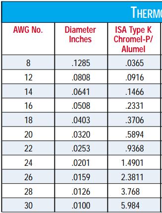

T/C alloys are much higher resistance the copper wire, so the use of any appreciable length of the T/C cable to get to a ground connection will have some wiring resistance. Bear in mind that the table is Ohms per double feet (out and back).

Simply connect the shield through the flange, but first check to see if it is grounded.
If so then leaving it isolated may be better to avoid ground loop issues.
