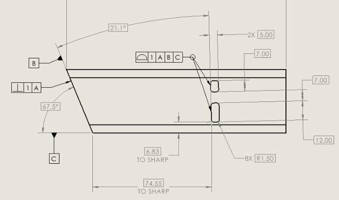

Hi All,
I am working on the part attached. The item is a tube with an angled cut that will be mitered with a mating tube inside of a weldment. The location of the rectangular slots from the angled face (datum B) is important. The slots themselves are angled and act as a locating feature for a tabbed plate (not shown). The slots are to penetrate both walls of the tube (the part is reversible). Because of how these slots are oriented (not parallel or perpendicular with any particular face) I am not sure of the best way to located & tolerance them.
My thought is that because the angle face is what's important they should be located from there. Due to the fact both the datum and slots are not parallel, I have opted to dimension from the corner of the miter to the sharp of the lower slot to set the x-position. Additionally I have defined datum C as the face of the tube angled basically 67.5 degrees from B. I use datum C to set the Y-position of the slot by basically dimensioning to the sharp. To control the overall location of the slots I am using an all around profile of surface on the two slots relative to A|B|C. I have defined the bottom face of the tube as datum A since the slots orientations to that face are important.
My questions are as follows:
1. Is this an appropriate dimensioning scheme for this application (i.e. is this a good way to locate these features or is there a more clear/easier to measure way to achieve the same result)?
2. Does Datum C need to be qualified to datums A or B, or is my current set up acceptable?
This is my first time posting so if any information appears to be missing or clarification is needed please let me know. Thank you!
 https://files.engineering.com/getfile.aspx?folder=f479db8d-01a5-4d33-b832-51d0cf2d3eec&file=SLOT_PROFILE_FROM_ANGLED_DATUM.JPG
I snipped just the key part; the end view is square tubing with large corner rounds. Datum feature A is the rear face of the tube. This view includes the tangency lines.

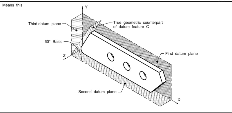

Basic dimensioning from the intersection of datum features B and C should work fine. Your datum selection scheme, by default, will set the origin of the datum reference frame (the coordinate system used for locating and orienting the tolerance zones) at the intersection of datums A, B, C.
You do need to qualify datum feature C relative to A primary, B secondary.
Since datum feature C appears to be a stock material face, I expect things will not go fine, but I don't want to go into datum targets when there is no clear function for the way it is currently dimensioned and toleranced.
It is probably better to use the 40 mm width between faces as datum feature A, instead of that one face.

Burunduk, what would be the purpose/benefit of utilizing the width feature as datum A as opposed to the one face?
3DDave, without having you go into too much detail, what is the problem you see with using the stock face as datum C?
I have attached the newest iteration of the drawing based on the feed back provided thus far.
Also looks like a good application for dual tolerance, one to control shape at a tight tolerance relative to A or A|B, and a looser tolerance for location A|B|C.
Words In Sequence,
The slots pass through both faces.
If you select one face as the primary datum feature, it means you directly control how perpendicular both through slots are to that one face, but you have much less control over the relationship of the slots to the other face. If both faces are equally important (which makes sense because the slots are through both), you may want to make a center plane datum out of them. With that said, the faces need to be adequately parallel to avoid an unstable primary datum feature. The tolerances that control the faces which may define the stock part could be a useful indication.

Your part would be way easier to fixture if the angled face were your tertiary datum feature, instead of secondary. I take it this is commercial off the shelf tubing?

That is an interesting point. Since they slots are oversized features to help locate a tab in a weldment I am not sure the tighter orientation requirement is necessary.

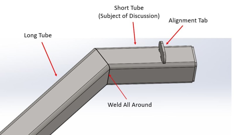

Perhaps an image showing the application is warranted. Please see below. The tube will be welded to the face of longer tube. The weldment is used inside of an assembly for a cart. The tabs welded to the short tube are used to line up the cart with the object it will carry.
Words_In_Sequence,
So what you really need is to locate that alignment tab.
Don't tell your welder how to do his job. Tell him where the alignment tab must go, and let him figure out the fabrication and fixturing.
