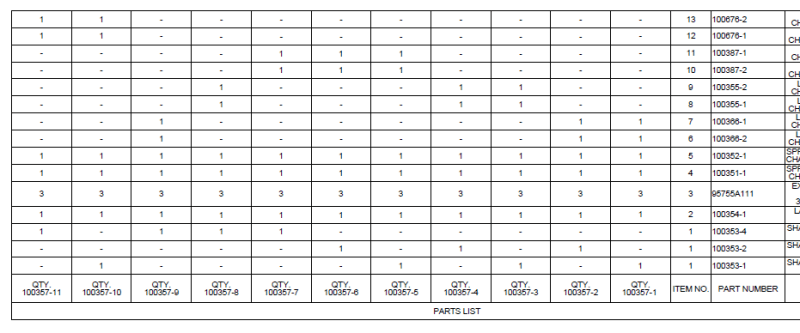

Hi Jboggs,
I have prints with many more than 2 assemblies and use this methodology with great success.
For instance,
Were you able to see if "Top-level only" was your BOM type in Solidworks?
That is exactly what I'm trying to do. Are those quantity values SW driven or manual?
My BOM setting is Top Level Only at the moment.
The values are Solidworks driven.
Just as you are trying to accomplish, I am not manually typing any of those values in.
The values are simply generated by the QTYs of each part number present in the different configurations.

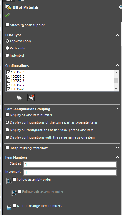

here are my settings from that BOM if it helps you to compare.
Here are my settings for one of the assembly configurations.
Hopefully there's a breadcrumb in there somewhere.

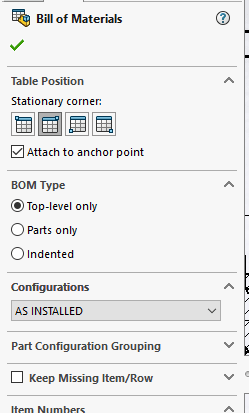

What version are you running? We just installed SW Premium 2023 and this is the BOM Properties box I see:
Note that the Configurations option selection is a "drop down menu" which only allows me to select ONE of the available options, and no more.

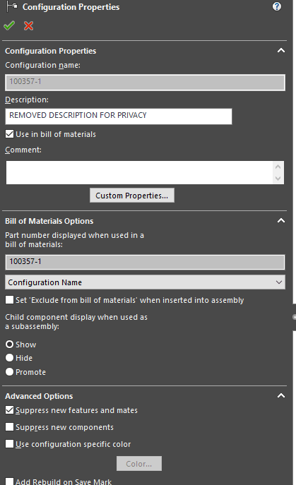

Right-click each config, select properties. Select box under Description "Use in bill of materials".
Chris, CSWP
SolidWorks
ctophers home
We are running 2022 SP5, but I'm hoping ctopher might have hit the nail on the head.
If you look at my previously posted snip, we do have "Use in bill of materials" checked.

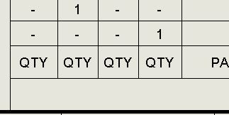

The one part that I always struggle with, adding the config's to a BOM and can't show the Qty for each one. It only shows "QTY".

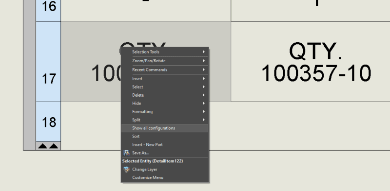

Yeah the behavior of the QTY cells is weird. At some point over the years, ours started acting very strange and unpredictable and we learned that "Show all configurations" had somehow become a determining factor (for us).
Ours were checked, and it was locking us in to an odd format and overwriting our attempts to format the BOM how we wanted.
Luckily, after we were made aware, simply unchecking that option was the solution in our case.
