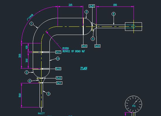

Hello
Am in need of performing proof test for the Pipe Bend.
As per ASME B16.9 Clause 9.3, we are arriving a proof test pressure of 79.6 Mpa.
Test Specimen Specification:
OD of pipe bend - 323.8mm
Thk of pipe bend - 25.4 mm
Ultimate tensile strength as per MTC -483.24 Mpa
We will be assembling the pipe bend with both end connected with the straight pipes with End plate.
I performed the Straight pipe & end plate strength calculation by the attached document(Excel file). But It seems to be fail. Can anyone elaborate this proof test concept & please conclude whether my Excel calculation is correct....
Thanks in advance
 https://files.engineering.com/getfile.aspx?folder=4f3356f1-72c4-4e94-8b9b-5a6368164c08&file=Hydro_test_-_End_plate.xls

Ah, OK this is a proof test to near rupture of a new bend making procedure?
Your issue is that the weakest part of the system needs to be the bend itself.
But if you use the same material and same thickness for the pipe identical to the elbow / bend, this pipe section could burst first before you get to the min proof pressure or yield so much that it causes the test to fail
IMHO, the pipe should be designed so that at the proof test pressure, it does not exceed 90% of its SMYS.
So you can either increase the thickness of the pipe or increase the strength of the pipe.
For the former using A105, I calculated for thickness this was nearly 60mm thick, so I suggest you use pipe like 5L X65 or X70 and a thinner thickness.

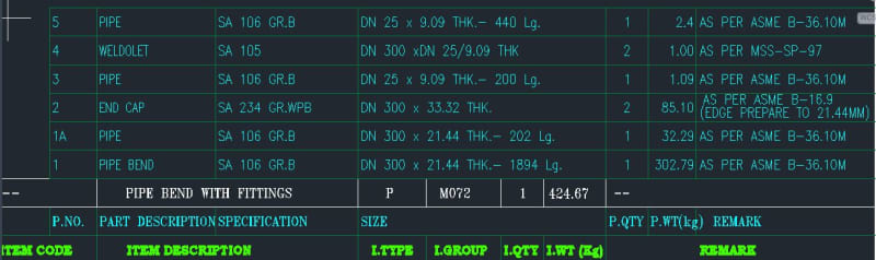

Yes, this bend is produced by the Hot induction bending machine (Heated first & then pipe bend will be done).
Actually we need to prove that our bending machine is capable for making pipe bend for the client. They are asking us to make a proof test for pipe bend. That's why we gone ahead with ASME B16.9 , Although it calls for Wrought fittings like elbow etc..
Pipe used for pipe bend is 300DN X 21.44 Thk (Bend radius =1000mm) & straight pipe at both end of pipe bend is 300DN X 21.44 thk
Proof test assembly is attached here for your easy reference
Thanks in advance.

Your first post said thickness 25.4mm, now it's 21.4mm - which one?
Your calculation appears to ignore the bend thinning. BS POD 8010 calculates this to be 12.5%.
SO I get a B16.9 test pressure to be about 600 bar based on a start pipe wt of 21.4mm, depending on what test factor you are using.
Don't understand why you don't just UT the bend after manufacture and take a load of hardness tests which are usually the critical thing for this type of bend.
This test does nothing for you or your client in my opinion in terms of knowing if your machine can do this. Many other factors at play here.
If you do it make sure you have a lot of concrete around it to avoid creating a serious risk to people. If 600 odd bar goes you could easily end up with bits flying off. Or very high velocity water jet.
The B16.9 test is at the measured UTS so it's a burst test. Not sure what happens of it breaks before the test pressure.
Ask a bit odd if you ask me.
Well, I don't understand why the calculations in the spreadsheet have a cylinder allowable stress of Yield. The connected cylinder has a calculated stress of UTS at the test pressure.
This is because the cylinder and elbow will have similar burst pressure if they are the same thickness.
If the cylinder and elbow have the same thickness, and the cylindrical pipe bursts before the elbow, then this is good. Just give the elbow the same rating as the connected pipe.
If my memory is right, this is how the philosophy of B16.9 works. (i.e. make sure the fitting bursts at a higher pressure than the connecting pipe, and then give it a pressure rating of the connecting pipe)
The calculation is wrong: UTS is 4218 kg/cm2 (60,000 psi). You need to use actual UTS from the material test report, may be over 4218 kg/cm2.
