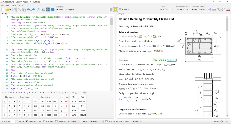

Another free worksheet for verification of column detailing to Eurocode 8 for DCM:
[URL unfurl="true"]https://calcpad.eu/Worksheet/100/column-detailing-for-dcm[/url]
The source code is available on GitHub:
[URL unfurl="true"]https://github.com/Proektsoftbg/Calcpad/blob/main/Examples/Structural Design/Reinforced Concrete/Seismic Detailing/Column Detailing for DCM.cpd[/url]
