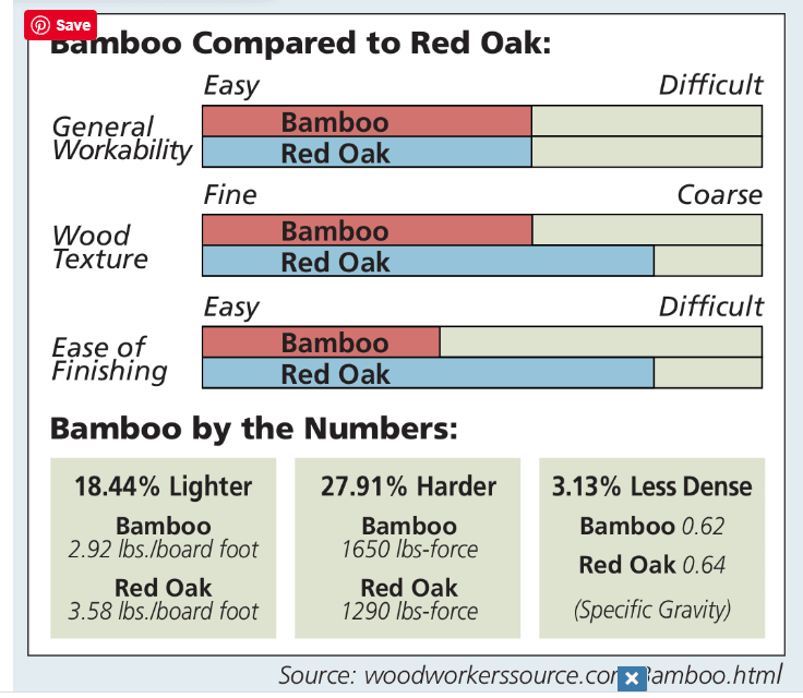

I read that some companies make bamboo plywood.
I'm in SoCal, been looking for a supplier, so far can't find one.
Anyone have experience with using it? Pros/cons?
I would like to find some and try it out.

I would think that it wood be really good. I remember researching bamboo about 55 years back when the sliderule I was going to purchase was fabricated from bamboo. I was surprised that it was so dimensionally stable. My sliderule has not delaminated in the time, and I suspect adhesives have improved.
On a positive note, nearly all bamboo will be quartersawn...[pipe]
Thanks. Being quartersawn is why I'm interested.
If I can find it, I would like to make some cabinets from it.

Looks like there is a place in San Diego that sells it:
I have not used it but it looks like neat good stuff!
The article linked above (from June 2019) mentions that the magazine included a list of sources on page 67. It looks like you may need to purchase a subscription to access that however.
