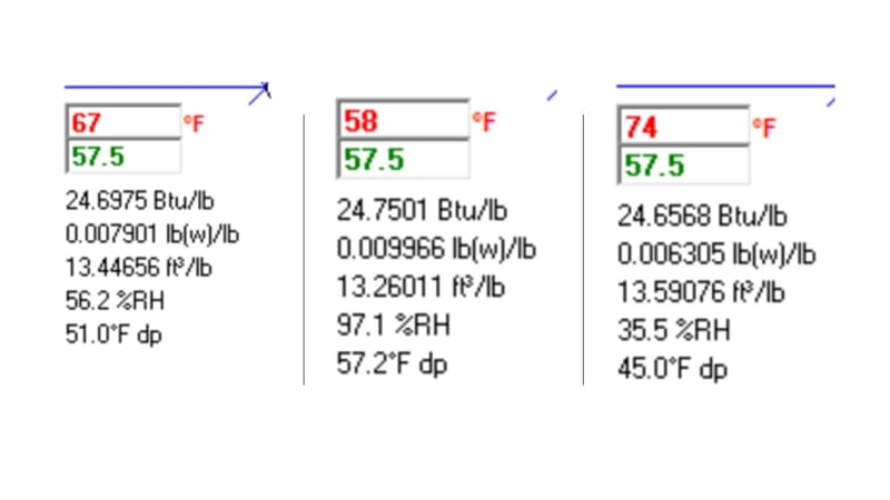

Not the sizing of heaters for heating the room, but rather the sizing of heaters to maintain the RH in the duct, is the subject of this post. As far as we are aware, the duct heater sizing equation is CFM*DT/3160. Using this, the air in the room is heated in accordance with the heat load. However, the necessary delta T is crucial to decreasing the rh level in order to preserve the supply air's relative humidity increasing from the saturated condition. For a 400-cfm unit, for instance, the ideal supply air temperature and relative humidity (RH) values are 58 F (WB 57.5) and 99%, respectively. In order to elevate the RH to 55% when plotting a psychrometric chart, the dB must increase to 68 °F (dt 10 °F). The heater will therefore be 400 * 10 * 3160 = 1.27 KW. Am I correct?

The assumption that WB temp stays constant is not correct.
Air at 58 deg F DB and 57.5 deg F WB is roughly 97%Rh as you indicated.
Heating this at 10 deg to 68 deg F DB, will result in roughly 68%Rh.
What %Rh are you trying to achieve, and why?
@MintJulep;Yes, you are right. The wet bulb is changing with sensible heating. So, I changed DB and RH.

The screenshots of your software show a drop in water content which means that to achieve your design point you need to reduce your water content, which you will not be able to do with a sensible heating process. I think need you to consult your application with a qualified mechanical engineer that understand psychrometrics.

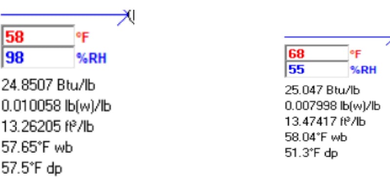

@ProcessHVAC:I think you didn't read the whole post. After the cooling coil, the text says "sensible heating," which means "heating the de-humidified air after the cooling coil." The heater in the duct comes after the cooling coil. In the first screen shot, I apologies there is a mistake that is causing the DB to change with a constant wet bulb. Look at the second screen shot, please.

@moideen You can't start at 58 deg F @ 98%rH and sensibly heat your way to 68 deg F @ 55% rH. You need additional dehumidification to achieve 55%Rh at 68 deg F dry bulb.
@moideen. Sorry, but I am not sure you really understand psychrometrics and if this is a real building and not "millennial homework" assistance, you are about to make a mess. Plot the two points on a psychrometric chart, does 68 F @ 55% RH follows a sensitive heating process off 58 F sat?. Then...you need to dehumidify further. I am not even convinced you need 68 F @ 55% RH if you do you will require about 50 F sat to sensibly heat up to 68 F @ 55% RH.
@ProcessHVAC ,BronYrAur-I plotted the same values using a psychometric chart; you are correct, thank you for pointing out the error. 55% RH is not possible at 68°F (20°C).
