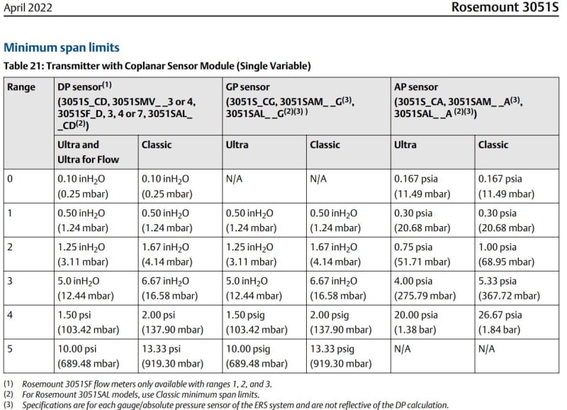

Can anyone tell me the minimum span on these ERS DP's ? I can not find a mininmum on Rosemounts sites .
spec sheet here, search for "minimum span"
Link
One of several charts, depending on type
It's been my experience that minimum spans do not meet the commonly published accuracy spec. Many brands have a calculation to determine accuracy at spans lower than the span used by marketing to tout accuracy.
