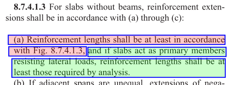

I've always found that diagram confusing. When you read the blurb below:
1) The red bit presents it as a minimum, somewhat implying that extensions should be based on analysis with the minimums just being the "floor" so to speak. Nothing explicitly says that detailing the rebar to the minimums constitutes detailing it adequately. I do realize that a great many firms do assume that extensions are adequate when the minimum extensions are provided however.
2) The green bit, in explicitly saying that extensions should be based on analysis for lateral loads, kind of implies that the the use of the table bar extensions is somehow adequate for gravity loads. Otherwise, why only mention lateral loads as needing to be detailed per analysis?
3) My understanding of the tabulated extensions is that they were developed in conjunction with the direct design method which has specific limits on geometry, loads, etc. Rationally, I'd only expect the tabulated extension to constitute adequate designs when the slab properties fall within the bounds of those limits. To my knowledge, there is nothing explicitly connecting the table to the direct design method in the current ACI code.

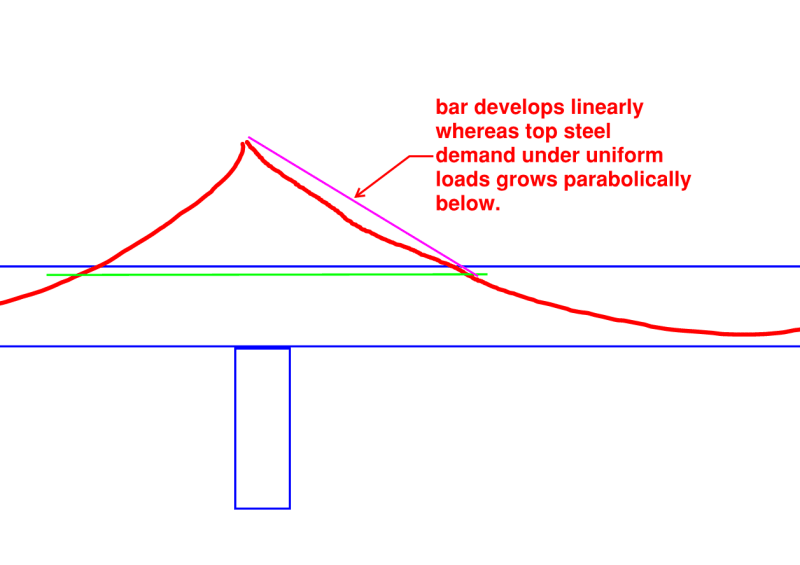

4) Excepting the above, and assuming a design for which the bar extensions would have been adequate as detailed in the table, I agree with ryaneng that introducing the epoxy should not much things up for top bars so long as you still have proper development by the time that you get to the critical section. In addition to development at the critical section, one also wants the partially developed tensile capacity of the bar to match the tensile demand at all locations in the slab. For uniform loads this should be self satisfying given the assumption of linear partial development in the bars as shown below.
