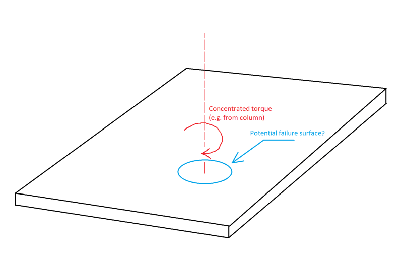

Something I've never really seen discussed before is the strength of a concrete slab subjected to a concentrated torque in its own plane.
The obvious failure mode (shown below) would be similar in a way to punching shear (similar in the sense that the failure surface is localised around the concentrated force), but the shear would be in the plane of the slab. I think this would be fairly easy to calculate by adapting current shear strength provisions in the codes.

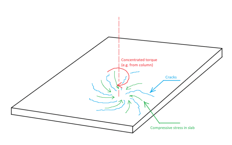

But then I got thinking about another failure mode like the one shown below, which would be limited by the tensile strength of the slab. I suppose this is similar to the torsion strength of a beam in that the torsional cracks align with the principal compressive stresses and are crossed by reinforcement, which provide the strength.
Has anyone dealt with this situation before?

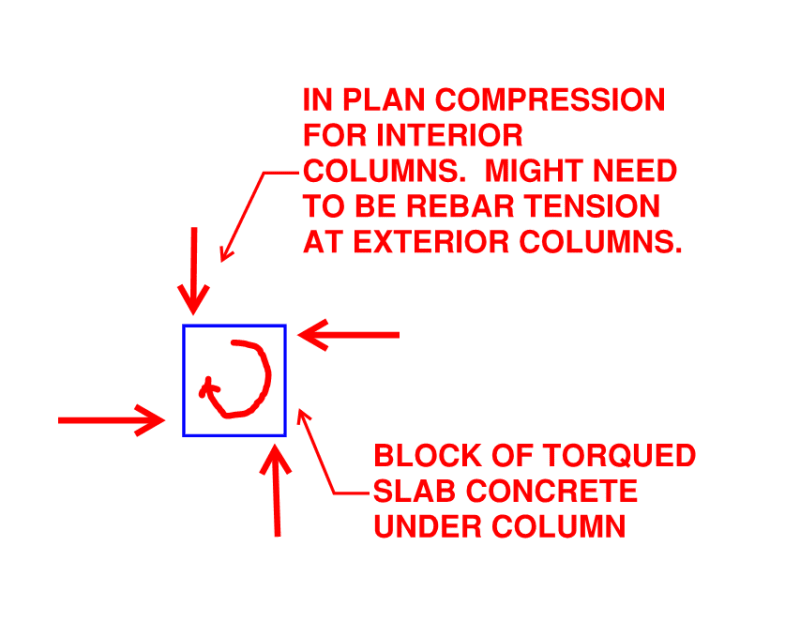

1) I don't feel that punching shear provisions make sense for this. The punching shear provisions are all about vertical shearing stresses whereas the torsional shearing stresses will be horizontal in nature. Apples and oranges.
2) As with most things, I feel that the stiffest mechanism of resistance will be the best one. To that end, I would propose that this works as shown in the sketch below wherein in plane forces in the slab resist the torsion. Those forces would themselves generate in plane slab shear in most cases but, then, that would be distributed over long lengths of slab and thus tend to be non-critical.
3) My gut feel is that the critical part of the design for something like this would not be the blob of torqued concrete beneath the column but, rather, making shear friction work for the torque at the interface between the column and the top of the slab.
