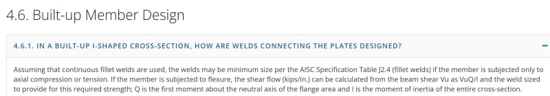

From the AISC website...

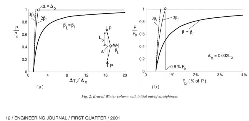

I think you are correct that the strength criterion is the one to look at here. Welds are enormously stiff and the stiffness requirement will surely be satisfied. The only way the weld can fail to provide restraint to buckling is if it has insufficient strength.
The required restraint force becomes smaller as stiffness increases, approaching a minimum requirement asymptotically.
