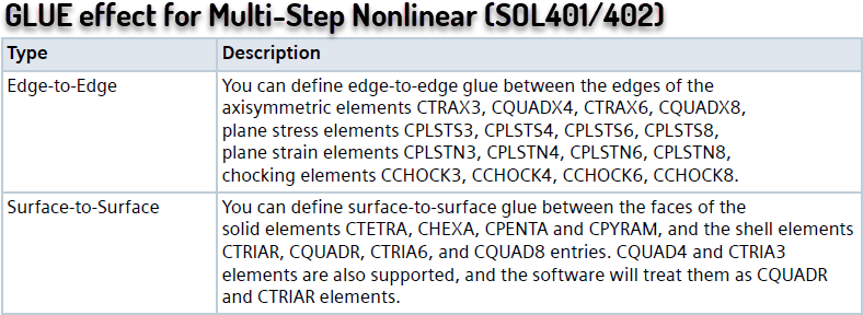

In regards to the merging of the nodes, what of the top and bottom shells did not have the same number of nodes ?
Dear Martin,
If the two neighboring parts do not have matched meshes I will have to check with an small pilot study if we can use glue surface-to-surface effect.
In the list of capabilities of GLUE effect I do not see support specifically for solid CHEXCZ, I will check.
