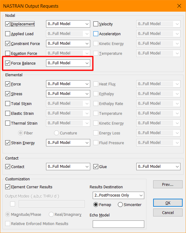

I run Simcenter FEMAP not NX/SC3D but the solver is the same Simcenter NASTRAN.
In FEMAP we have the capability to plot FREEBODY Diagrams, this is critical to investigate reactions and loading transmision along the model. This will incluide the card GPFORCE in the nastran input file that requests grid point force balance at selected grid points. Grid point force balance is computed from linear and nonlinear elements, the sum of applied and thermal loads, and MPC and SPC forces.

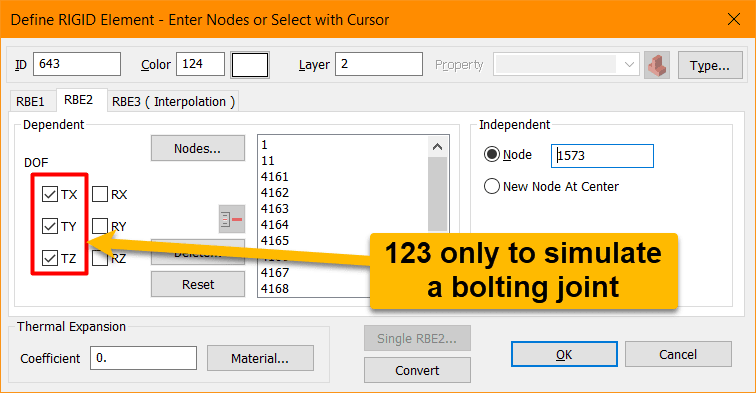

I have created a simply problem of a wall plate with a welded cantilever beam under different loiads cases of shear, bending and axial loadings using RBE2 elements to simulate how the plate is bolted to the wall.

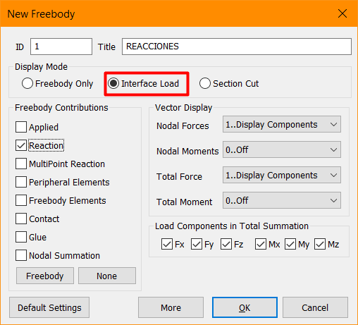

If I run the model I can create a FREEBODY to compute reaction forces anywhere I need, for instance at bolting joints:

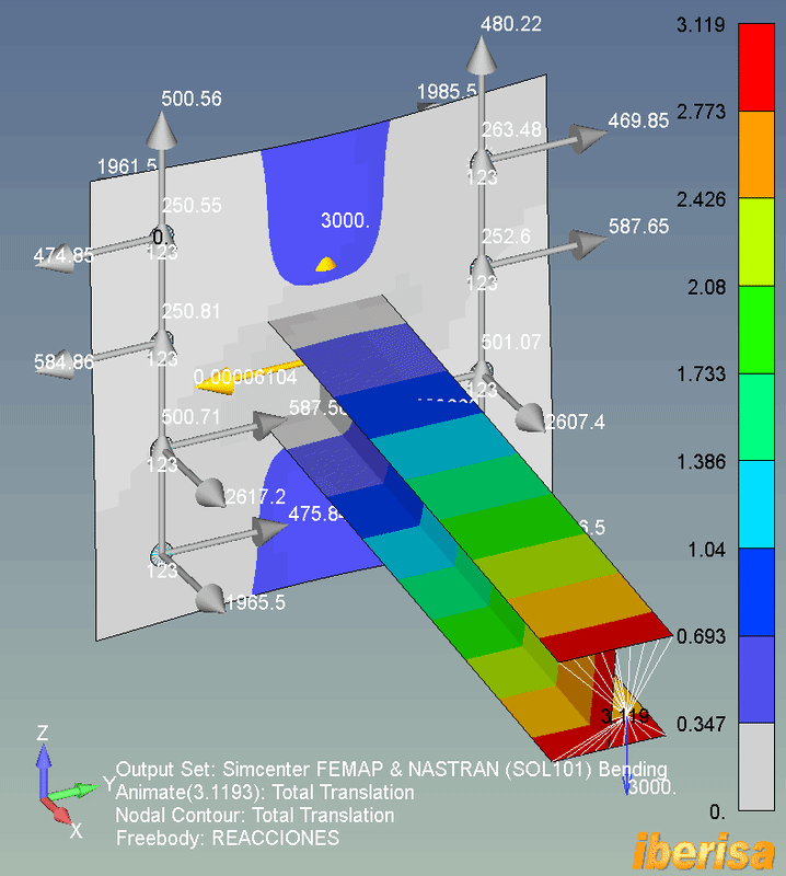

You have the components of the reactions forces in the INDEPENDENT node of the RBE2 elements and also the summary of reaction forces: +3000 N, exactly equal to the applied load FZ=-3000 N.
I can animate results:
