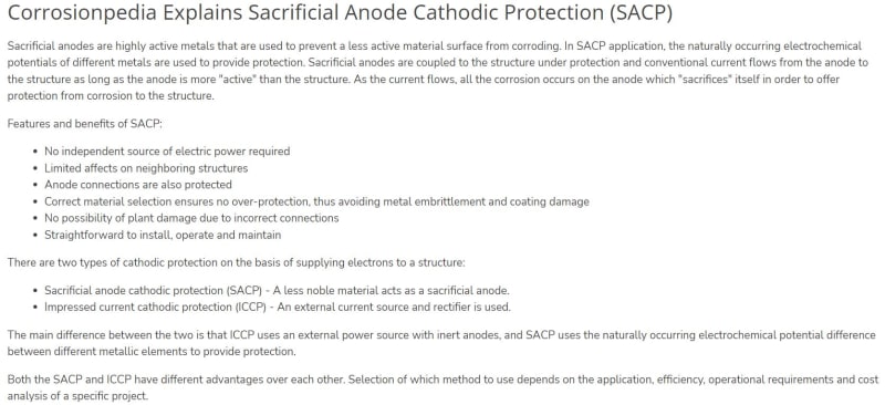

May you kindly share the experience of how you rectified the low concrete cover of the bored pile that's already cast? The specified concrete cover should be 75mm but it's found less than 30mm at the actual site. To add an additional concrete cover or providing a protective coating on the concrete surfaces is not possible as the bored pile length is 33m below the ground level.
Here is the attached picture.
There's not much you can do, but evaluate the effects to see if concrete cover is acceptable. You may be able to add some passive cathodic protection.

@Dik: Thank you for your response. I think CP system is an option to consider. What do you think about leaving the piles as they are if the structural engineers prove that these piles only receive compression loads? Or we can just add another shorter piles alongside to resist any uplift and lateral load effects as only the top portion of the piles need the reinforcing rebars?

It's not a strength issue, I think. It's a corrosion one. Unless you have fairly large bars, the flexural strength will not be diminished by much based on the cover. Corrosion would be my main issue.
