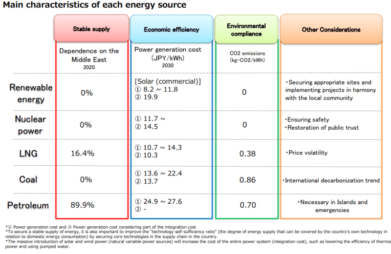

I don't know their methodology, but this is what METI have come up with for Japan 131 Yen to the USD, cost in Y per kWh
nuclear 11.5
LNG 10.7
Onshore wind 19.8
solar 12.9
Which is interesting to say the least. All of these numbers are rather high in Australian terms, so one might hope they are realistic. I'm having a dig around for the report itself

Which is somewhat different to the above, nukes still cheaper than renewables once you put integration costs in
