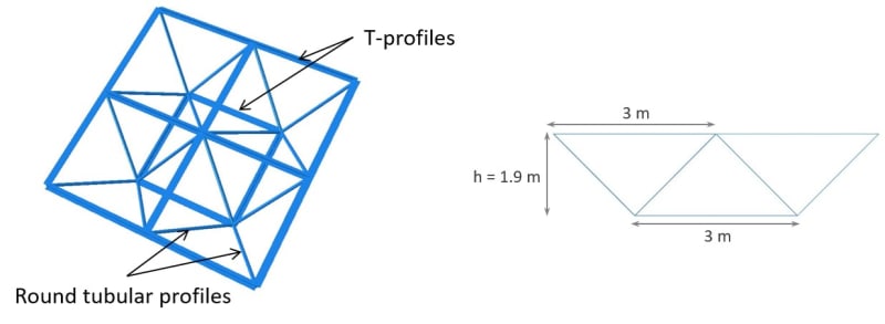

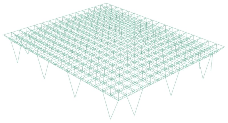

I’m modeling a metallic structure whose roof collapsed under snow weight. I modeled this structure using beam elements and I specify that the roof elements are bolted together (no ball joint).
The calculation is made in static and the snow loading is applied using linear forces.
In small displacements, the code diverges while I have not reached the steel ultimate strength; I get the following error message: “The strain increment is so large that the program will not attempt the plasticity calculation at 171 points. The plasticity/creep/connector friction algorithm did not converge at 55 points.” I tried to increase the time period, to decrease the initial and minimum increment sizes, to increase AI or to reduce the size of the mesh… Nothing works! And in big displacements, the code diverges even earlier! As a result, I can’t perform risk analysis integrating imperfections.
I would appreciate a recommendation on how to improve convergence in small and big displacements?

What's the frame look like?

I don’t necessarily expect my model to converge but the error message is not clear. I can’t know if the code is diverging because the structure collapses or because there’s a numerical convergence problem.

Depth of the trusses looks too small.
Some dimensions would help.

The building is 54 m long, 45 m wide and 8.9 m high. You will find attached a description of one single roof frame element; the outside and inside diameters of the tubes are 48.30 mm and 42.5 mm respectively.
 https://files.engineering.com/getfile.aspx?folder=90046b88-6b79-4228-b3af-7258d18256a6&file=RoofFrameElementDimensions.png

1.9m depth of truss is probably half of what you will need to control deflection.

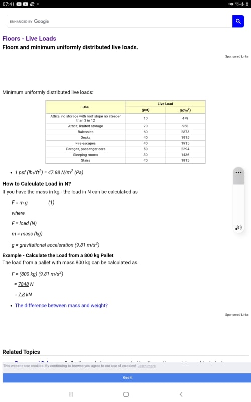

N/m^2 is the definition of Pascal, not MPa. 294 MPa is about 42 ksi.
Engineering Toolbox uses N/m2 for roof loads.
I use Pa for fluid pressure and stress.
The 500 N/m2 roof load produces 42ksi member stress.
